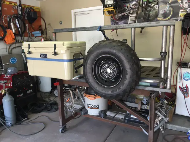

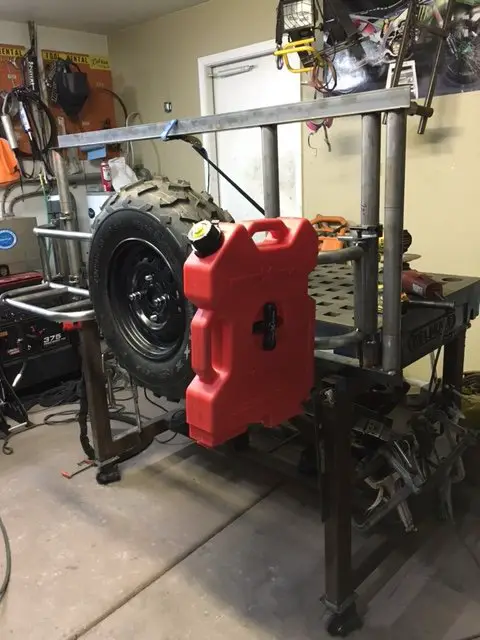

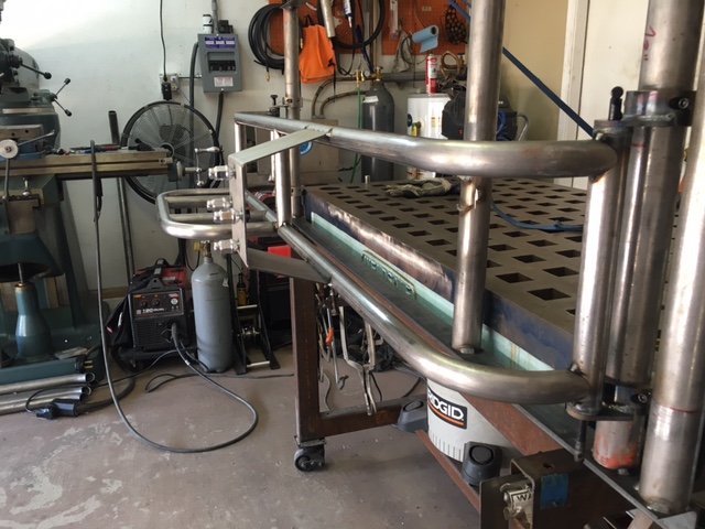

P700 honda pioneer spare tire rack with cooler and rotopax mount

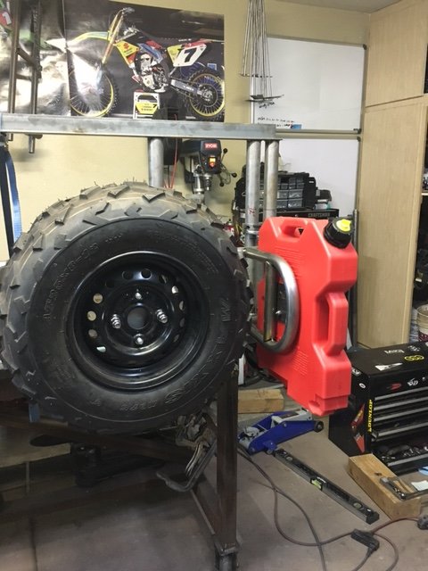

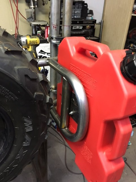

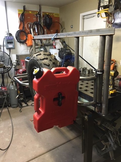

I'm guessing that you can easily removed all 4 pins and remove the rack completely. Also can the Rotopax connecter be left off?
Also can you PM me a price?
Manwell
Manwell
Jul 12, 2016
803
2,440
Yes, that is correct and another great feature...

That rack is F'n sweet Moses!! Great work!!!

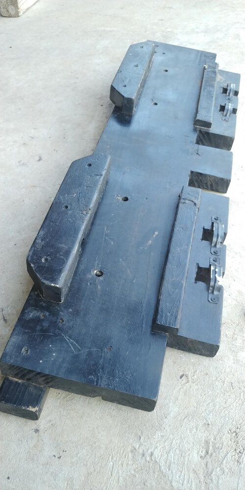

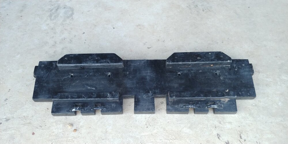

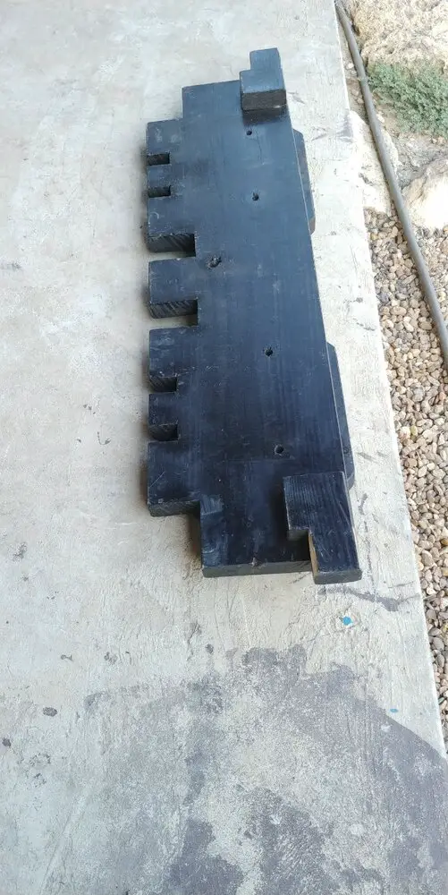

700-4 rear seat back seat booster, cubby shelf, storage, fender flare, truck bed mods.
IMG 20201029 195750 IMG 20201029 195806 IMG 20201029 195814 IMG 20201029 195826

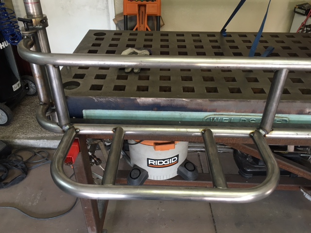

OK. I looked it up.
REALLY expensive.
$705 plus hardware. I can save $260 if I fab the mounting bracket to attach to my roll bar.
Or... Maybe I can fab one. I don't have the equipment to perfectly bend the tubes. But Maybe I can make a drawing.
Most muffler shops can do pretty smooth bends if the tube isn't too thick. I made a rod and downrigger holder for my boat awhile back out of 2" x0.035wall aluminum tube and had a local muffler shop do the bends. Dropped it off and ate lunch...cost me a case of Bud...bends were nice with just very fine wrinkles and I bird mouthed and TIGed it together and works great. A tube notcher does fine in a drill press if you're careful.
