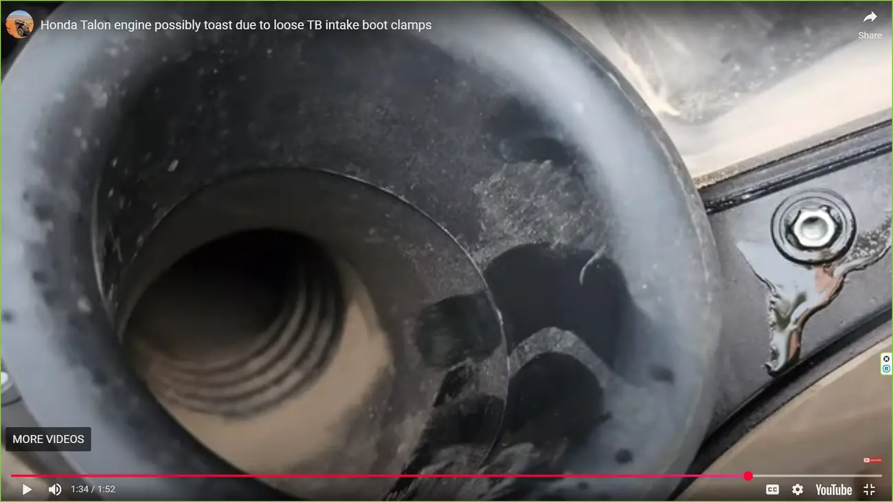

From the video in the first post -

With the amount of dirt in that intake tube, it doesn't much matter other than mechanical curiosity, the engine's rear cylinder is trashed.
The oil next to those threads and amount of dirt in the "dirty" side of the airbox makes me think the filter was clogged and started sucking oil from the valve cover vent.
Then possibly the air filter/seal failed and sucked that dirt into the air horn.
Doesn't explain the clamps.

  1. Talon R LV
Does PaulF no longer contribute here? If not, that is too bad. On the other forum he pretty much solves this. In short, it appears someone previously took the thing apart and neglected to retighten the clamps, and there are clues in the pictures to support this, including changes to the clamps. He also rightly notes that if this were a Honda manufacturing problem, it wouldn't have taken 9600 miles to manifest.
Hello_Darkness
Hello_Darkness
Jun 6, 2024
681
2,764
Just to the right of nowhere
I figured the same, this wouldn't have taken that long to manifest itself.
Probably a valve adjustment and someone forgot to tighten clamps back.
