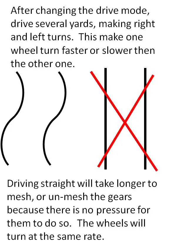

My P1000-5 Trail has i-4wd and sometimes it takes a long time to go into 4wd after moving the shifter, wondering if anyone has details on adjusting the cable at the front diff?

And then along with what they said ☝️ ☝️ ☝️
Page 50 in your Owners Manual.
"After changing the drive mode, drive several yards, make right and
left turns, and make sure the indicators work properly."
Drive mode changing
Have a good day
Thanks, I did miss that in the manual. Checked the cable adjuster earlier today and it looks good. I will give the wheel left-right manoeuvres a try next time I’m out.
