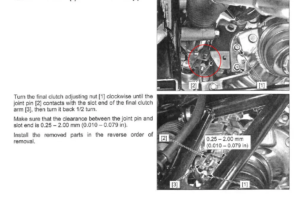

Hi guys! Im having a problem with My 2018 pioneer 1000-3 le I-4WD, when it log when its on 4wd it sound like a stripping yoke, a bang noise, with a loose washer sound or whatever! But everything seems working fine. Anybody knows what this might be?

There is a cable adjustment for the front diff to lock the driveshaft to the front differential. It's on the passenger side, behind the axle. There is a plastic cover over it. It might need to be tightened as the cables do stretch.

Looked and sounded like it was doing it in 2wd also. Hard to say what that is. Maybe pull around on the driveshafts and check the motor mounts...? The front diff not engaging makes a popping and/or spline grinding noise in 4wd only.
