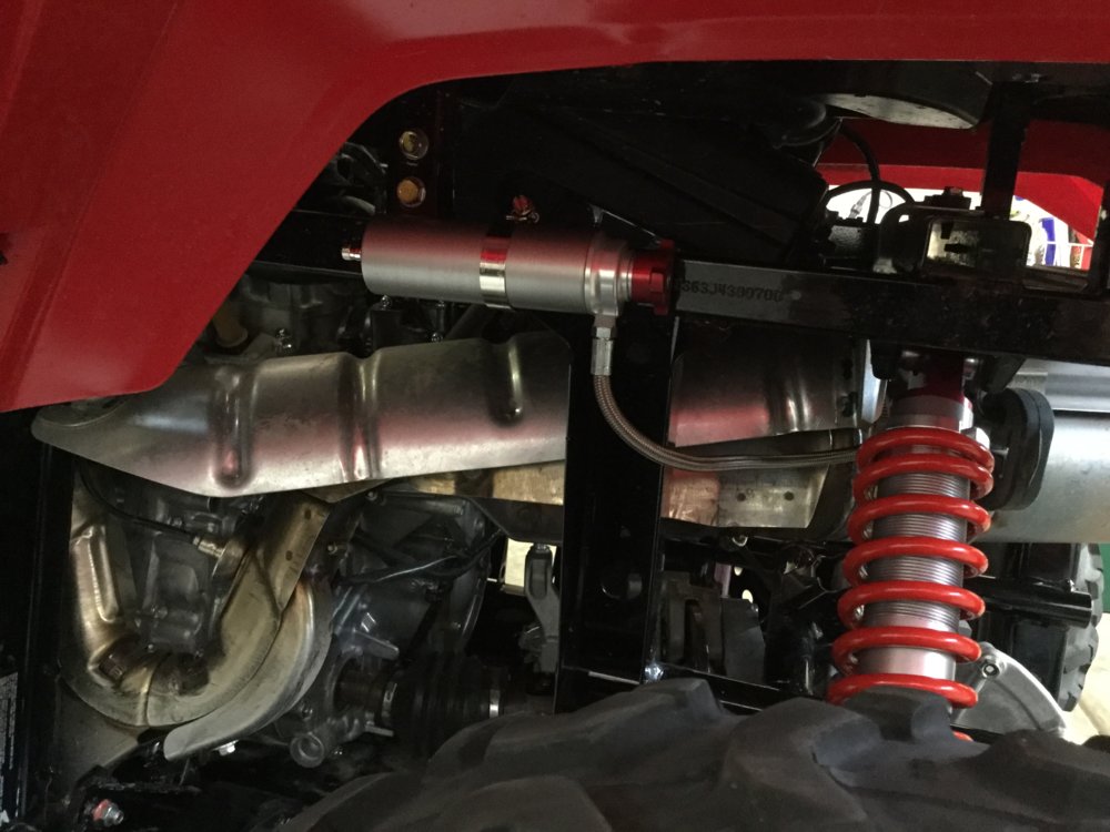

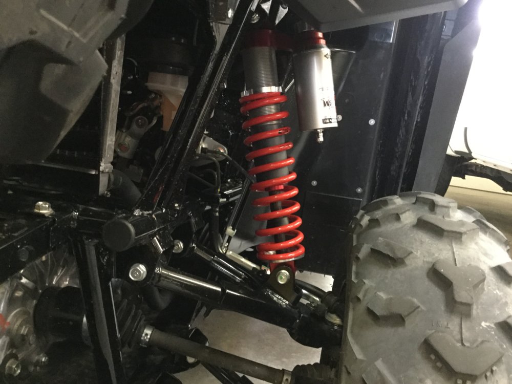

View attachment 106234 View attachment 106233
Boy, no kidding on the WE shocks. Just put 4 on my p 500 2018 model. They came with at least 2.5 inches of height gain on the front.....a test ride noted a slight vibration probably due to the increased drive shaft angle to the wheels. I ended up backing off the preload collar to stock height. I think one could probably get at least 3/4 inch or a bit more without any drive shaft vibration due to the increased angle on the cv joints. Get the angle to steep on the drive shaft to the wheels and it will bind per the dealer. I’ll probably go with taller tires and wheel spacers for more ground clearance and stability when the piggy bank recovers from the Walker Evans shock upgrade. Can’t comment on the ride change yet...have not been on any trails after the upgrade. The new shocks have 12 steps on the hydraulic shock absorber remote chamber. View attachment 106234
How much thread do you have on the shock collar now? I have Elka Stage one and i have adjusted to have one full inch of thread showing on the top. Think i will try a little more. Biggest improvement anyone can make to the P5 is shocks.

I’m afraid my input is not applicable now since I’ve installed the long travel kit with new 800 lb per inch springs on the back and the old rear springs moved up to the front. Be sure to check the flex on the passenger front tire axle ( shorter than the driver side axle) as you may experience binding of the joint if you get the preload set too high in your quest for ground clearance. Jack the front up until the tires clear the ground and rotate the tire by hand with it in neutral. If you are getting any binding, you need to back off the preload. This is the ultimate test for preloading the springs to gain ground clearance. If you are not happy with the ground clearance, try taller tires, but be aware as you go up in clearance your center of gravity goes up and it will tip over easier on off camber slopes or high speed cornering. The solution to that is 2 inch spacers front and rear. I have some posts on how to calculate the roll over angle with increasing ground clearance. If you can’t find them, I can send you some info, diagram, etc.

Thanks for info. I will check that. I have 26 inch radial on now with One inch spacers on the back. I will be moving them to the front and putting two inch spacers on the back soon. The spacers made a big difference.
