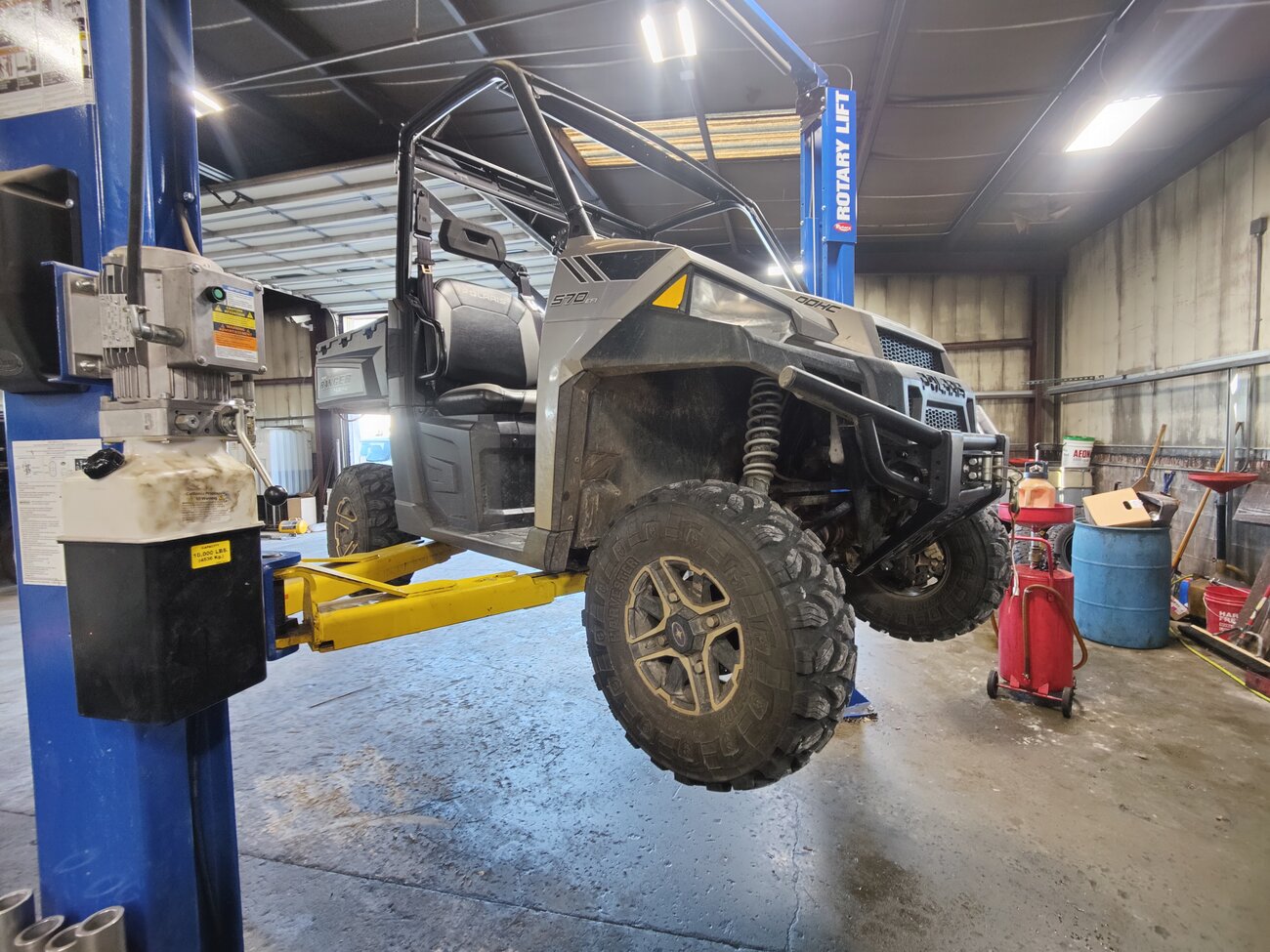

Checking over a 20 Polaris Ranger 570 EPS with 3097 miles. Complaint of a clicking while driving. Found the following.
U-joint at front diff basically falling apart.
U-joint at rear diff has excessive play.
Left front lower ball joint; I am surprised it is still together. A wrong bump and I am confident it would separate.
Front brake pads gone and digging into the rotors.
Rear brake pads maybe 1mm left.
Left front inner cv boot leaking.
Left rear inner cv boot clamp missing.
Left rear lower hub bushing basically gone.
Right rear lower hub bushing has excessive play.
I just thought this was interesting.
Vehicle is used to check cattle. The owner says he rarely hauls anything in the bed.
