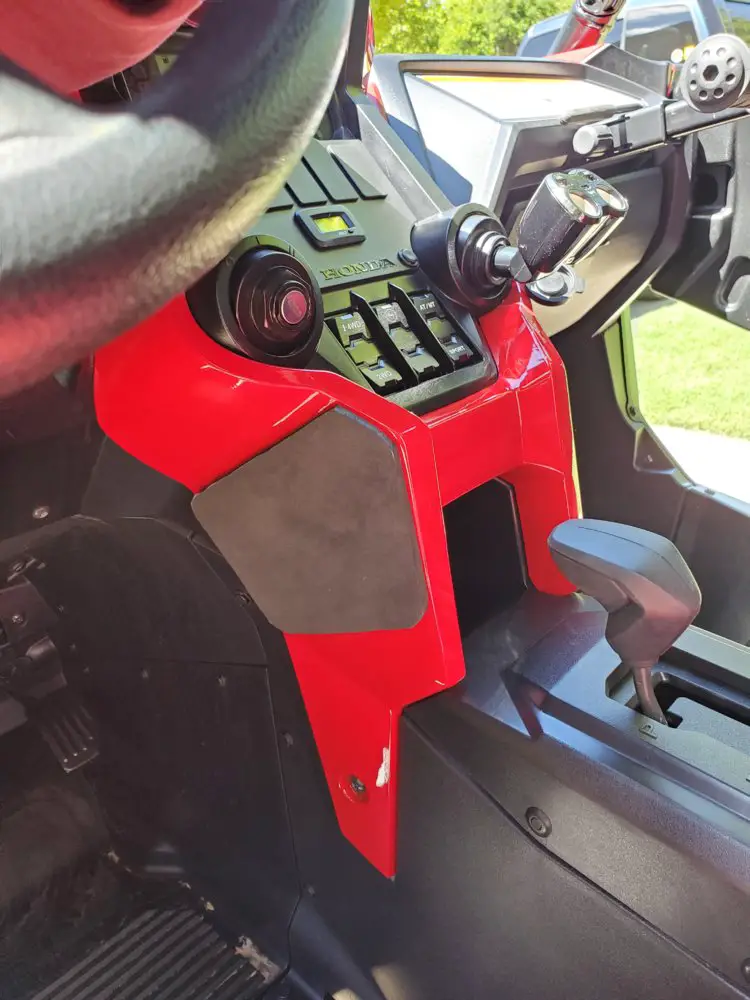

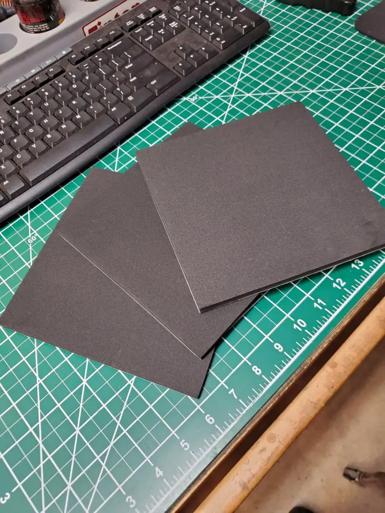

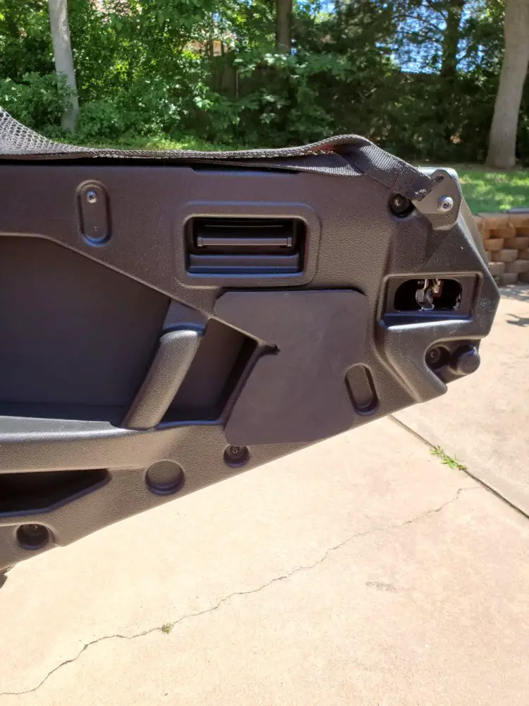

I'm 6'4" and the Talon is right on the ragged edge of comfort for me, with the seat in the most rearward position. Even then, my knees rest on the red console and the door panel. This isn't a big deal for short rides, but can become uncomfortable over longer duration rides or particularly rough terrain. To mitigate this (hopefully) I've come up with a fairly simple solution. I ordered some adhesive backed neoprene material from Amazon, 5/16" thick, 7" x 7" squares. The package included 10 pieces and cost $15.99 shipped (if you're a Prime member).

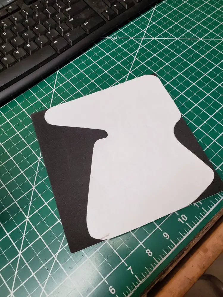

I used a piece of copier paper to fashion a template, laying it on the affected area and tracing the desired shape with a pencil, cutting it out and transferring it to one of the neoprene squares. Then, I cut the neoprene using a sharp X-Acto knife. Finally, I cleaned the area thoroughly with rubbing alcohol and applied the pad. Here's a few pictures of the results:
20190519 112058
20190519 112155
20190519 111818
20190519 111959
Haven't spent any time yet on the trail since installing the pads, but hope it provides a useful remedy. Here's a link to the neoprene squares from Amazon:
Neoprene Sponge Foam Rubber Squares
If you're long-legged like me you might want to give it a shot.

Good idea, nice job
17,511
104,857
I wish it would help in the 500. Being 6'9" I have no room for a pad. Had I the option to remove the wheel well, I would've done so, but then I'd eat mud and my foot would get ripped off. I see a market for your pads to the public. Great Idea.
Thanks, 100Acre!

Great idea! You win the "Keep It Simple" award. I've been trying to come up with some way to keep my knee from getting worn out by console on rough trails.

So doing this, I am 6’4” as well so definitely can see this helping.

I love that Steve, are you making them for all? $$$
