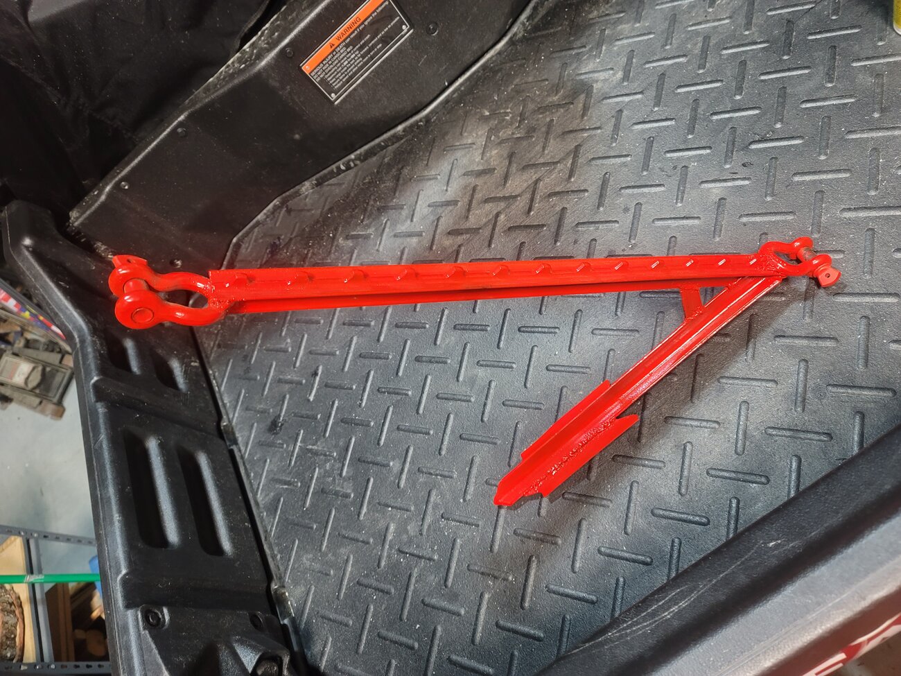

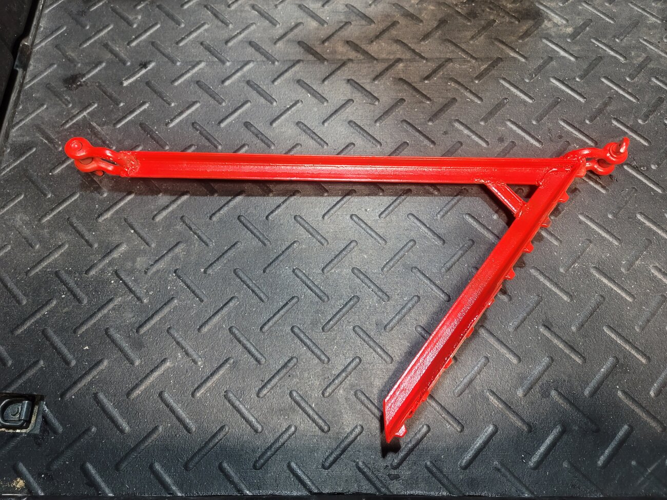

Here is what I built for our ATV out of a fence post and scrap metal. I I opted to used I would need to beef up the angle support but it works great.
Good idea, Pirata!
Can you set it up by yourself, or do you need a buddy to hold it while you start to tighten your winch line?
Do you think another piece of gusseting further up would increase the rigidity for a heavier vehicle?
I like the concept and use of readily available materials.

Dunno if I'd trust making it out of a fence post, the emphasis there leans towards making them "cheap" rather than going for strength. From my limited experience, it doesn't take a whole lot of side loading to bend them and the "T" shape doesn't lend itself to resist twisting or torque all that well.

I have a wireless remote for the winch on my ATV however if I was using the remote on out UTV I would either need someone to hold it or be within remote cable range.
I have not seen a structural capacity for a fence post but after pulling hundreds of them over the years I have had many bend but only 2 that I remember break. Side to side is where you lose the rigidity and strength. Put her in straight and she should be good. I even put a shackle on the end to attach a strap before use so you can recover the anchor after use. Another idea I toyed with was using a plow style boat anchor as they are designed to dig in and welding a recovery shackle on the back side would be easy.
