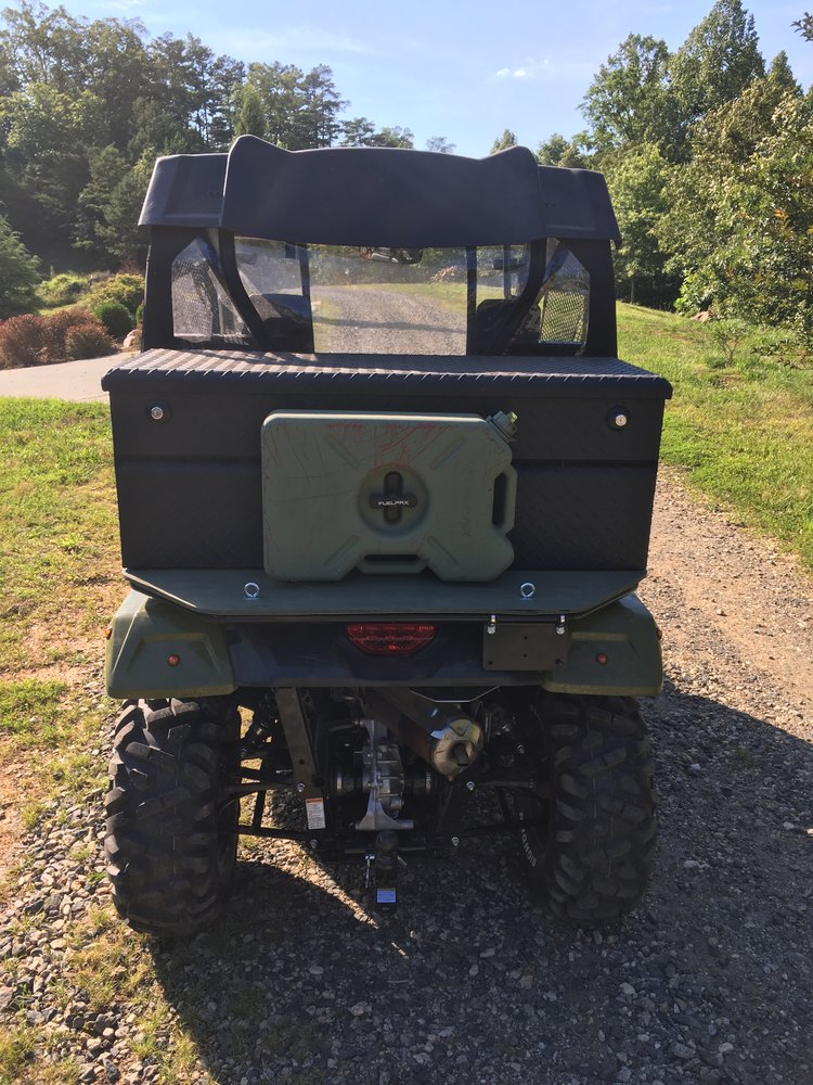

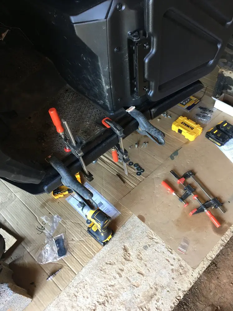

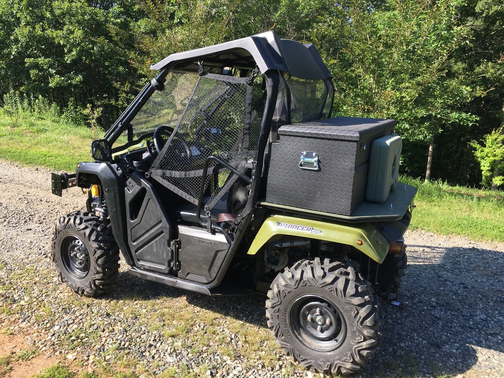

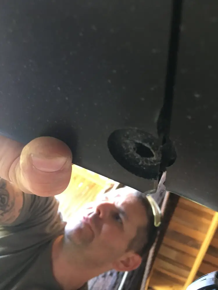

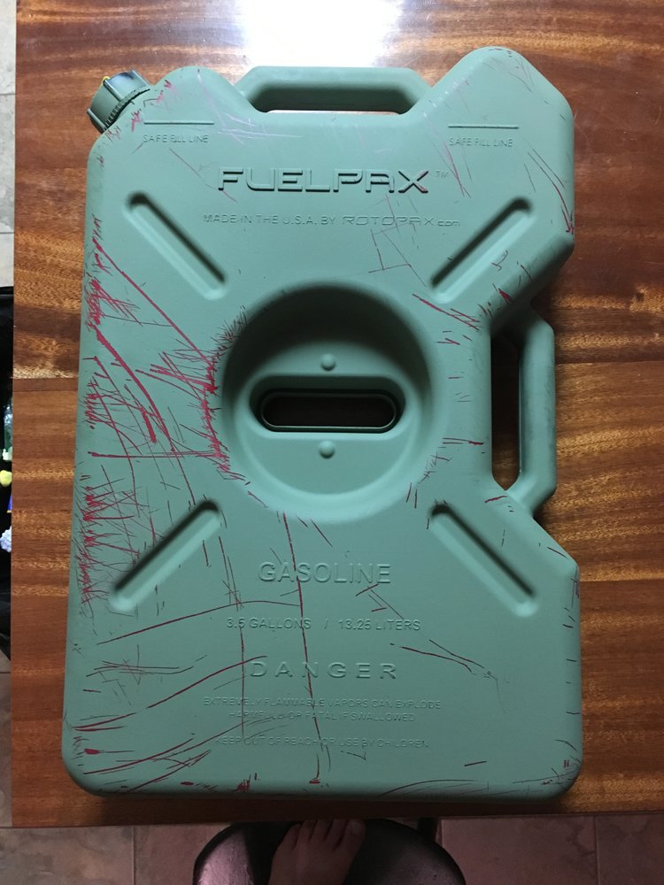

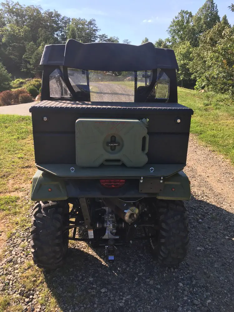

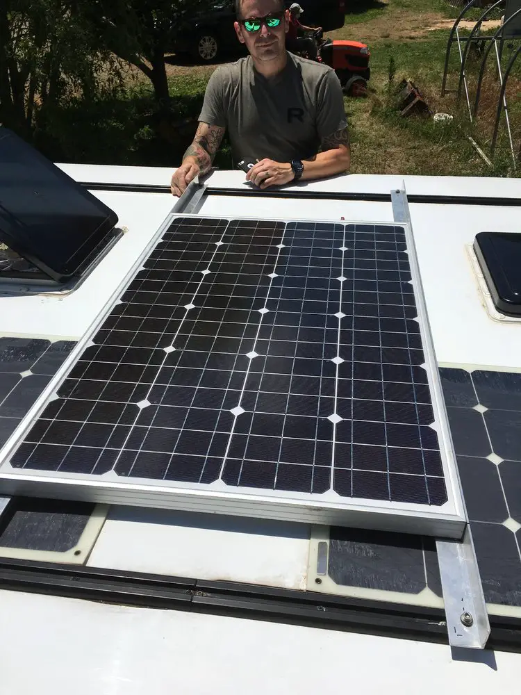

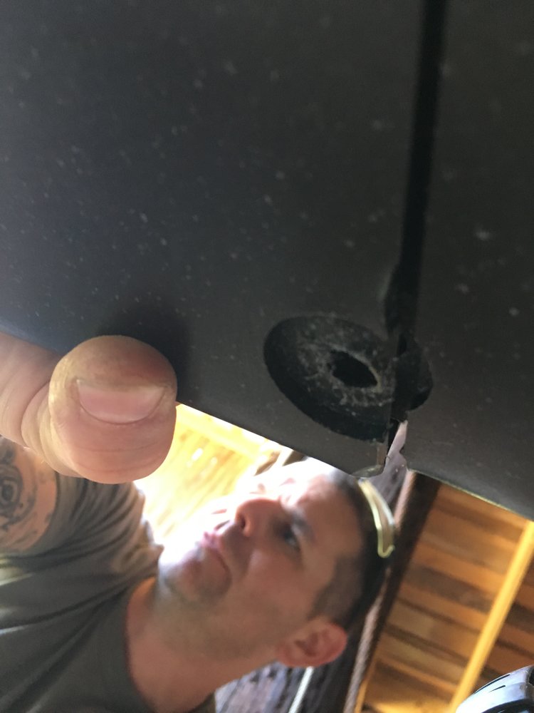

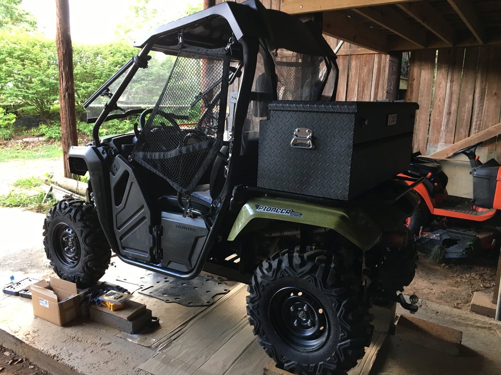

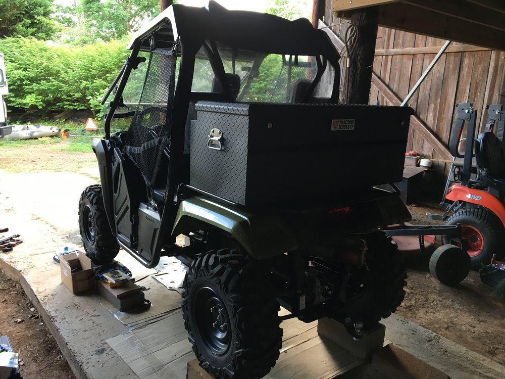

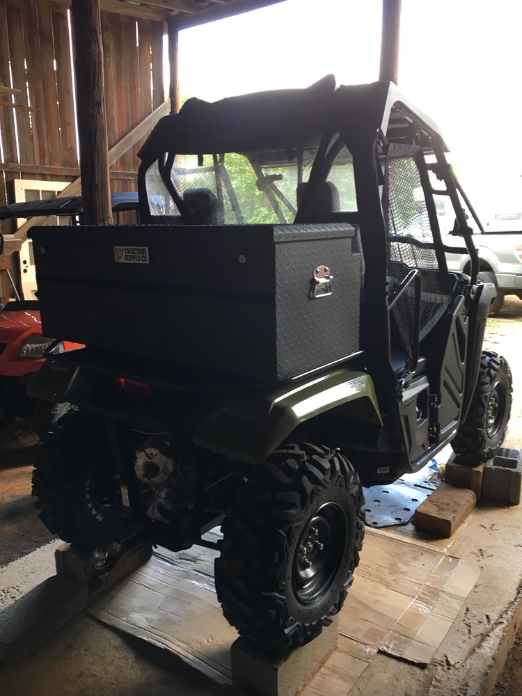

So, today my buddy came over to lend a helping hand and we changed the front and rear differential fluids, mounted the SSS Off Road UMHW Skid Plates, and we attached the black aluminum tool box to the board and rack using (6) 1.5" self tappers. Yes, I know, I drilled into the rack; woe is me. I think it'll be just fine. He also helped me fabricate some angle aluminum to attach the 100 Watt solar panel to the roof of the camper. We used the existing 6mm Yakima Allen wrench SS Hardware. We bolted 3 on each side for horizontal support and used one bolt for each corner. On the sliders, they say to drill, tap and die, but we just used 1" self tappers and washers. We also mounted the 3.5 gallon FuelPax horizontal on the rear of the tool box and then put in two eye bolts for attachment points. I still need to find a tube to clamp the fire extinguisher to. Maybe behind my head.

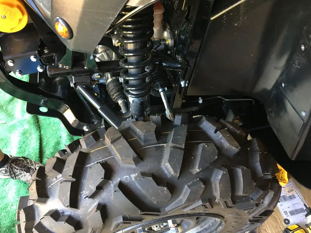

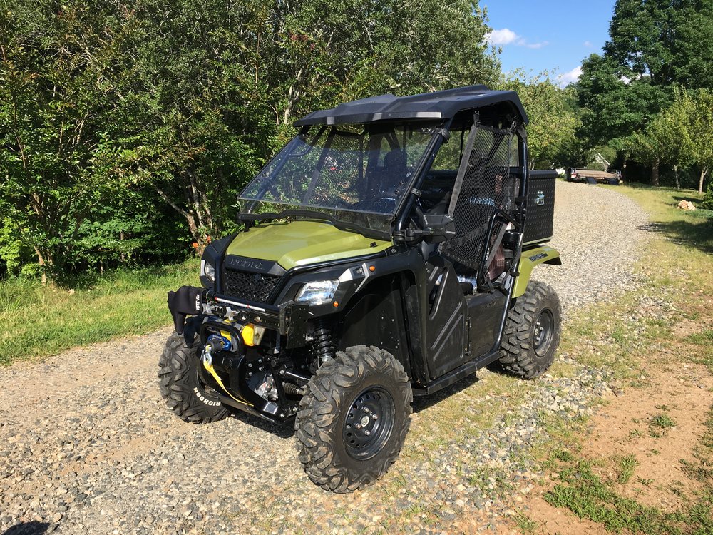

I'm at a point where I can chill out for a while. I dropped a few Pennines on it and want to hold back before I get lights a stereo or anything else. I'm thinking she looks good. I got some seat time on her today too. She was up on blocks for 2.5 weeks as I was slowly adding accessories. Seemed to bounce a bit more. Was wondering if it's all the extra weight or that I'm running 10 psi? The noise/ heat barrier I made is amazing for noise reduction!
26,638
195,716
After removing the sway bar I cranked my shocks up another notch in the rear, made it less spongey. Easy to do.
17,707
106,259
Can I crank mine without replacing the shocks? if so, how much and which way?
26,638
195,716
Absolutely. If you look at them you will see a gear looking thing at the top. They make a special wrench for it but I just used a pipe wrench. Turn it to the next notch that raises the shock. Mine is actually up two notches from stock.
