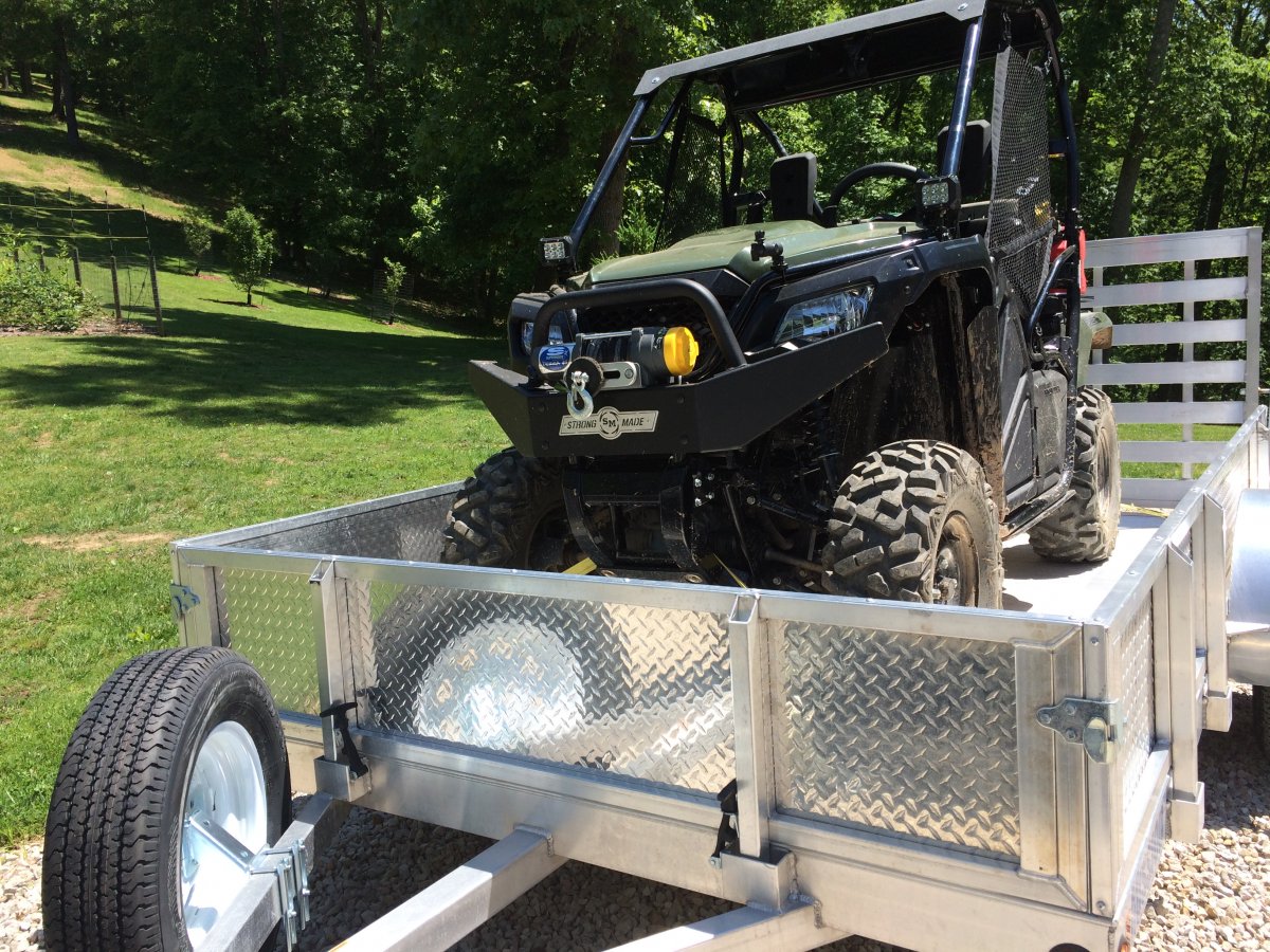

I never installed one on the tip out (Standard is pretty easy).
The tip out does limit options as it has to move. Maybe make a bracket to attach to the roll bar mount on the hood and kick it out far enough for the windshield to clear - the draw back will be it will block the hood access possibly depending on the height. I personally went with LED cubes mounted to the roll bar mount and it allows full access to my hood and plenty of light for the woods at night.
The tip out does limit options as it has to move. Maybe make a bracket to attach to the roll bar mount on the hood and kick it out far enough for the windshield to clear - the draw back will be it will block the hood access possibly depending on the height. I personally went with LED cubes mounted to the roll bar mount and it allows full access to my hood and plenty of light for the woods at night.View attachment 6283
What type of brackets did you use for those?
Code54
Code54
Jan 31, 2015
585
635
Hurricane West Virginia
I personally just used a piece of ¼ bar steel and made a twisted L bracket (Bend an L, the twist it - then drill it to fit the bolts for the roll bar mount)
Hope that makes sense - if you need a close up photo let me know
