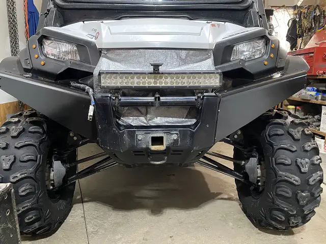

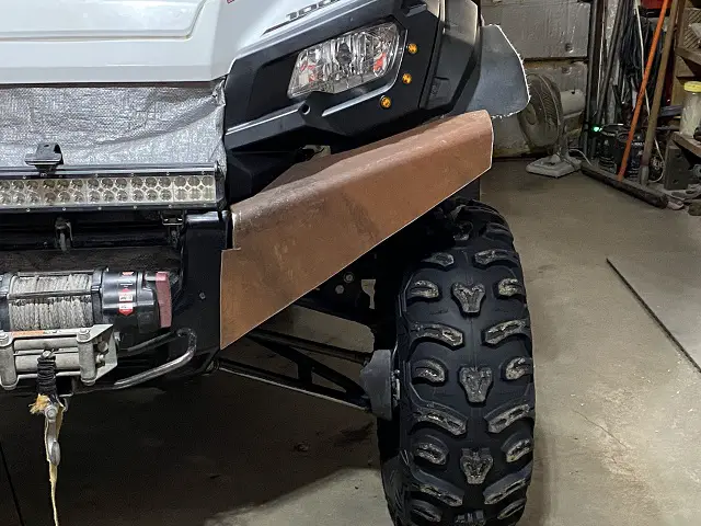

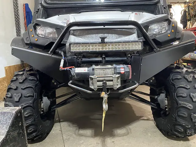

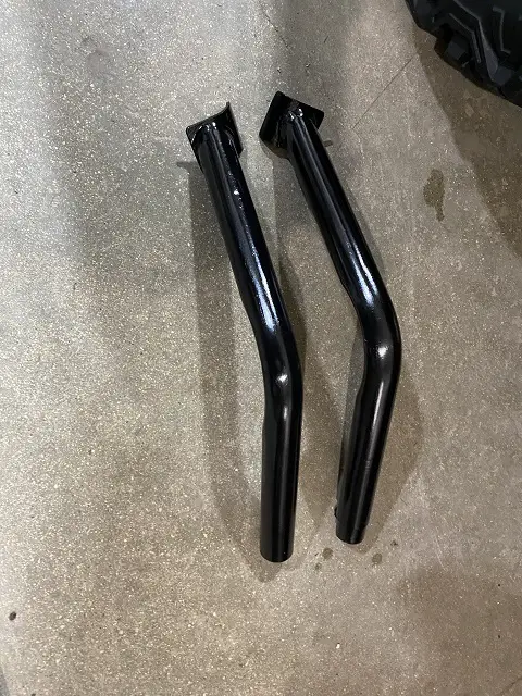

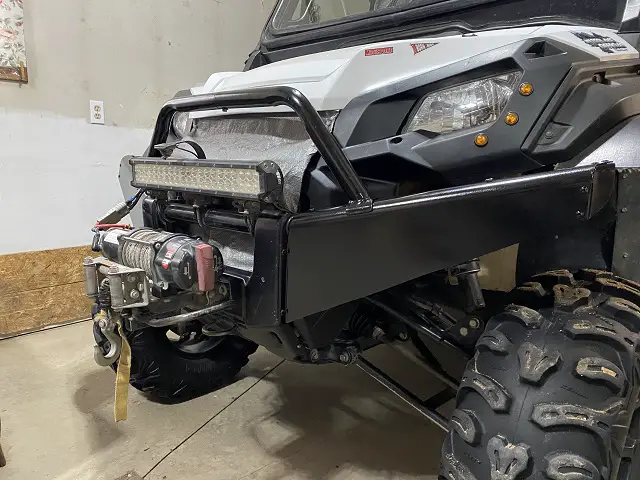

Got tired of the old look . So using some 18 gauge from the hood of a old square baler and some light tubing from a tread mill I made this bolt on bolt together front bumper . Sure added a beefier look to the machine. Used cereal box to mock up then transfer to the metal .

Awesome fab work - now that’s a true build item
