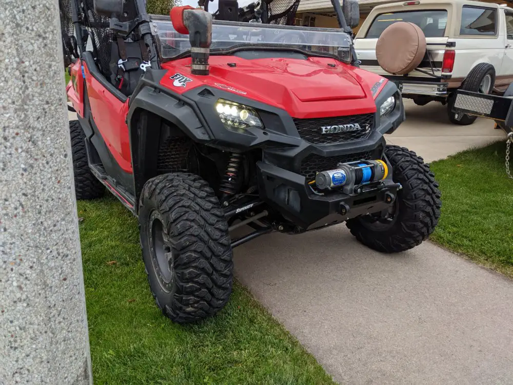

I like the Quadboss QBT846. Just about every 28-30" tire has been reviewed on this page.
I would say they lack in deep mud traction but they do well in sand and hard packed trails. They grip great on rocks and are quiet on pavement. They also wear like truck tires, almost no wear in 2000 miles.

Todd what bumper is that?
