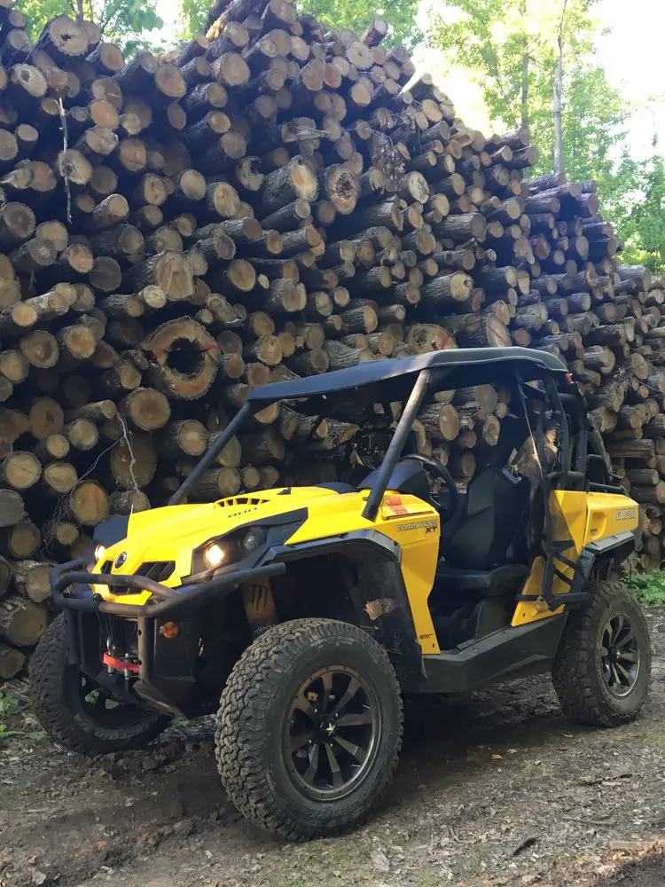

I've been running BFG AT KO2 for a couple years. Over 1200 miles and hard to see any wear at all. LOTS of street and highway running since UTV's are street legal in AZ and you can ride from your house.
I've run the BFG's in the AZ desert and Wisconsin trails and logging roads. They are very predictable and great when it's dry. I don't do deep mud.
Mopar commented that BFG's are heavy as hell. NOT TRUE!
Here the weights I've measured for several 14 and 15 inch wheel and tire combos I have owned - all on aluminum wheels.
28" Mongrels on HD3 wheels - 42.6 lbs
BFG 215/75-15 on MSA wheels - 42.8 lbs
27x11 Bighorns on stock Commander rear wheels - 43.2 lbs
28" Bajacross on ITP wheels - 47.8 lbs
28" Tensors on HD3 wheels - 49.2 lbs
IMG 0367

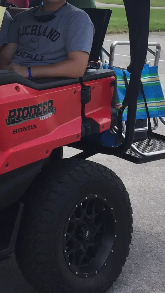

They are mounted. Machine is still at the dealer getting a pinion seal. I haven't seen the tires yet. I will keep you posted
Since I never followed up with this tread, here's a bit more info
The Quadboss 846 28x10x14 tires are a bit small compared to their actual size. The tires measure 27x9 on all 4 stock wheels with 14 psi. They are quite a bit larger than stock even though they measure a bit smaller than advertised
Here are a few photos.
15055023213731013379124 15055023483642127464744 IMG 20170913 162248942 HDR IMG 20170913 162253157 IMG 20170915 140624476
