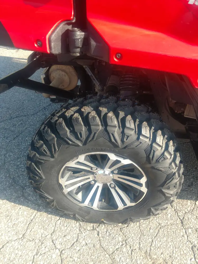

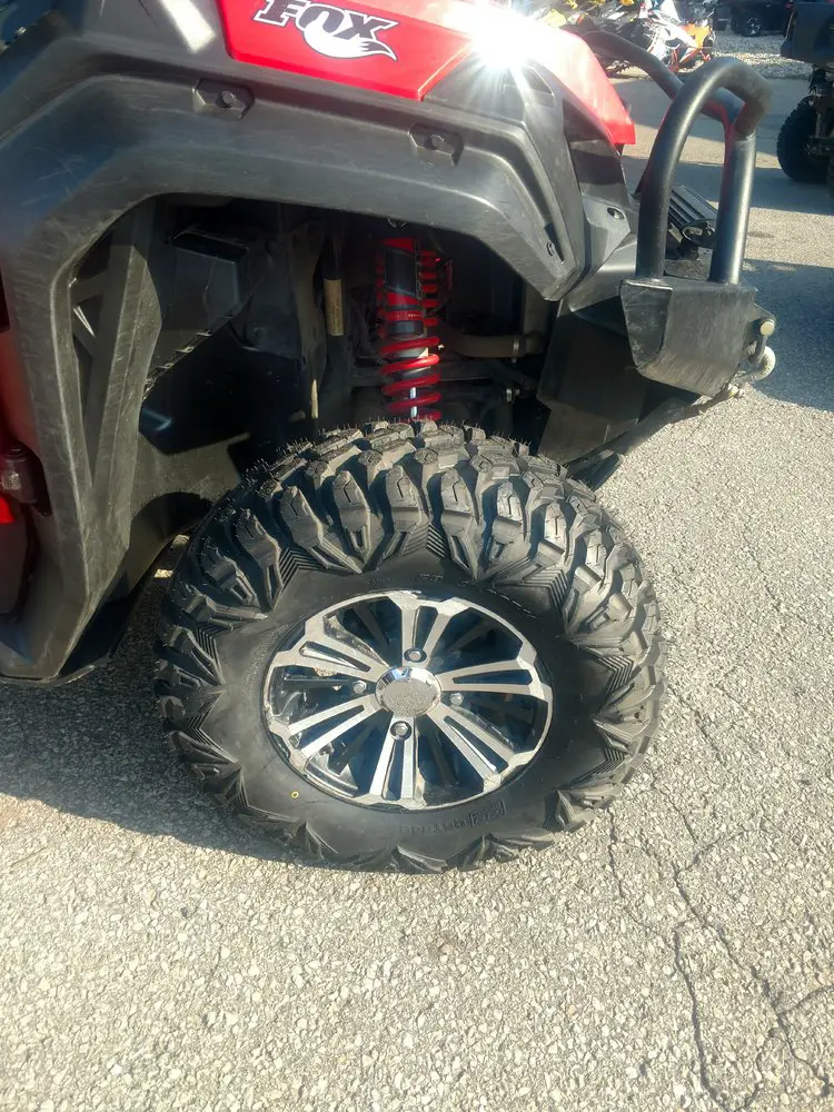

These are 28x10x14 Quadboss qbt846 tires on stock wheels

I just did today.. terrabites on stock deluxe rims. Who told you that?

No lift kit and stock arms. I do have front fox shocks which sit about 3/4" higher than my worn out stock shocks (800 miles)
