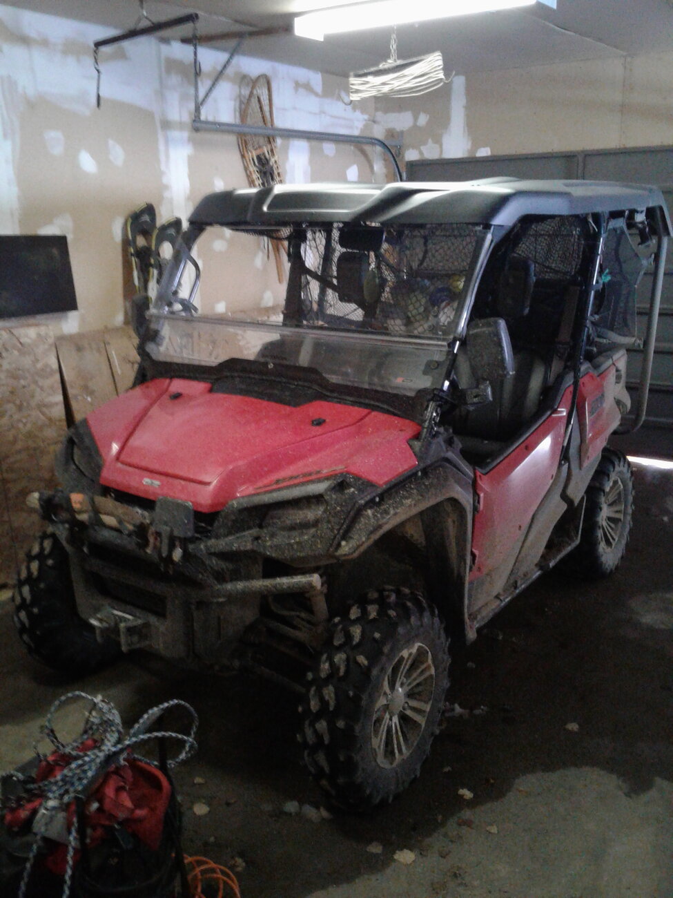

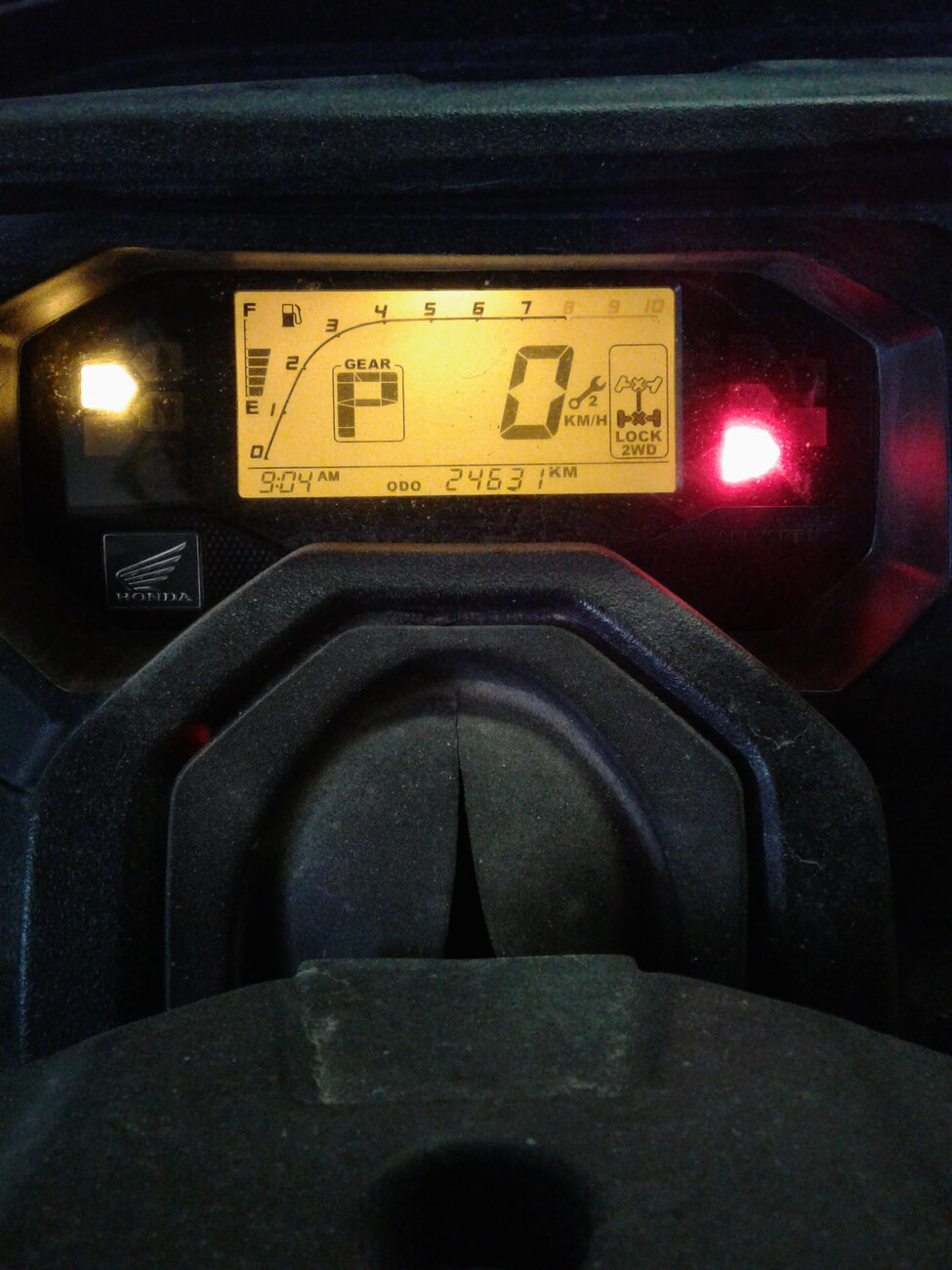

The miles really add up quick, 24,631 km in less than 8 years. (15,304.9 miles) Have only replaced one set of tires and the plugs and fuel pump because fuel pump and filter are one unit and felt it needed it. The rest is all original. Best machine I have ever seen. 20230409 09094220230409 091015

The miles really add up quick, 24,631 km in less than 8 years. (15,304.9 miles) Have only replaced one set of tires and the plugs and fuel pump because fuel pump and filter are one unit and felt it needed it. The rest is all original. Best machine I have ever seen.View attachment 382647View attachment 382648
Nice! Thats sweet youve had the luck u have had. My 16’ ive had since new and Im at 4,500 miles. Of corse thats split with an old P5 i had and now Talon in the stable or Id be around 10k fo sho!
Did u do the clutch campaign when it was out? Workd of difference fo sho!
Yes I had all the recalls done including the clutch. I have had no problems with the transmission but took advantage of the recall anyway. The Talon is a very nice machine but not for me as no place for my 2 hunting dogs to ride.
