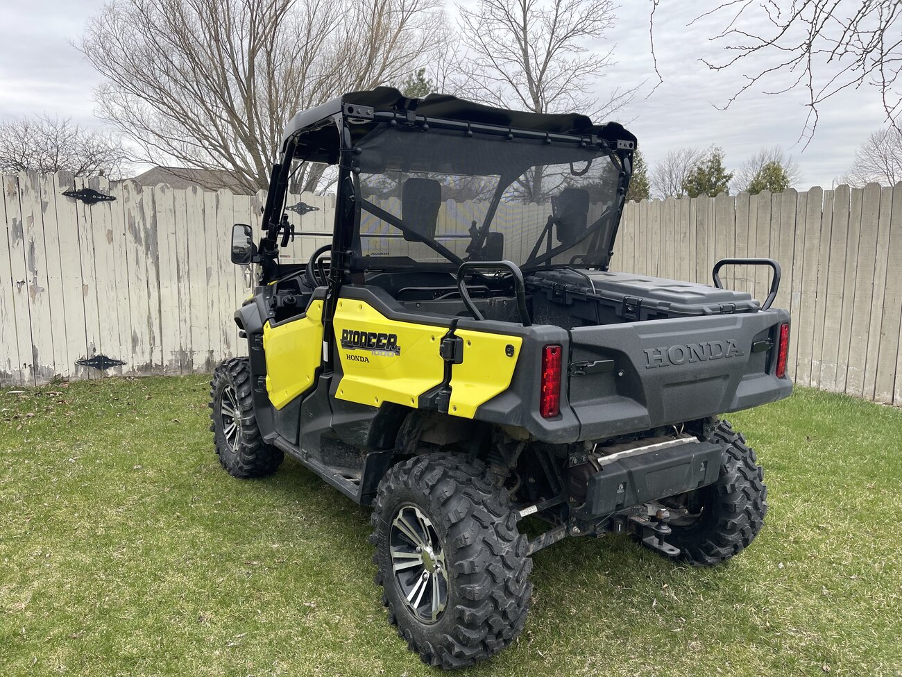

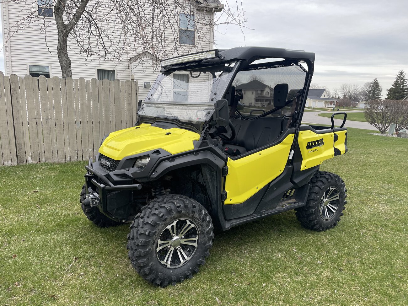

Running 28x10x14 all around at 10 psi. Not problems. System 3 xtr 370’s.

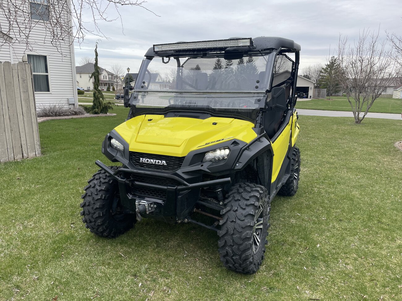

My 28x10-14 Sedona Rip Saws on 5x2 Remington wheels did not fit without rubbing at full turn. Close but not going to work on my '22 1000-5. Thought I would be fine by what I read on the forum, but now I'll have to find some way around it, because the tires look like they'll work great.
