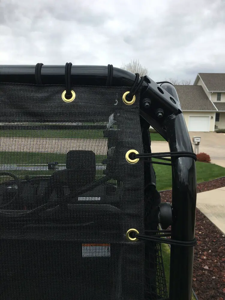

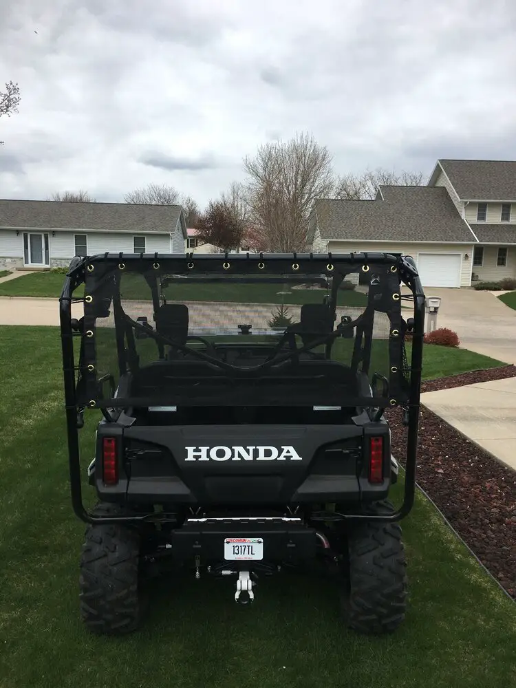

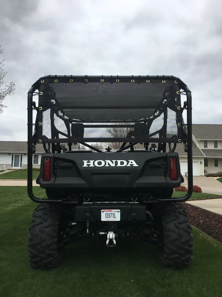

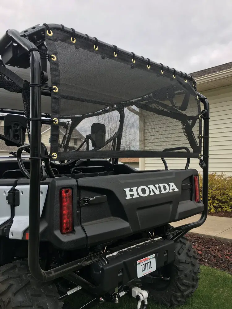

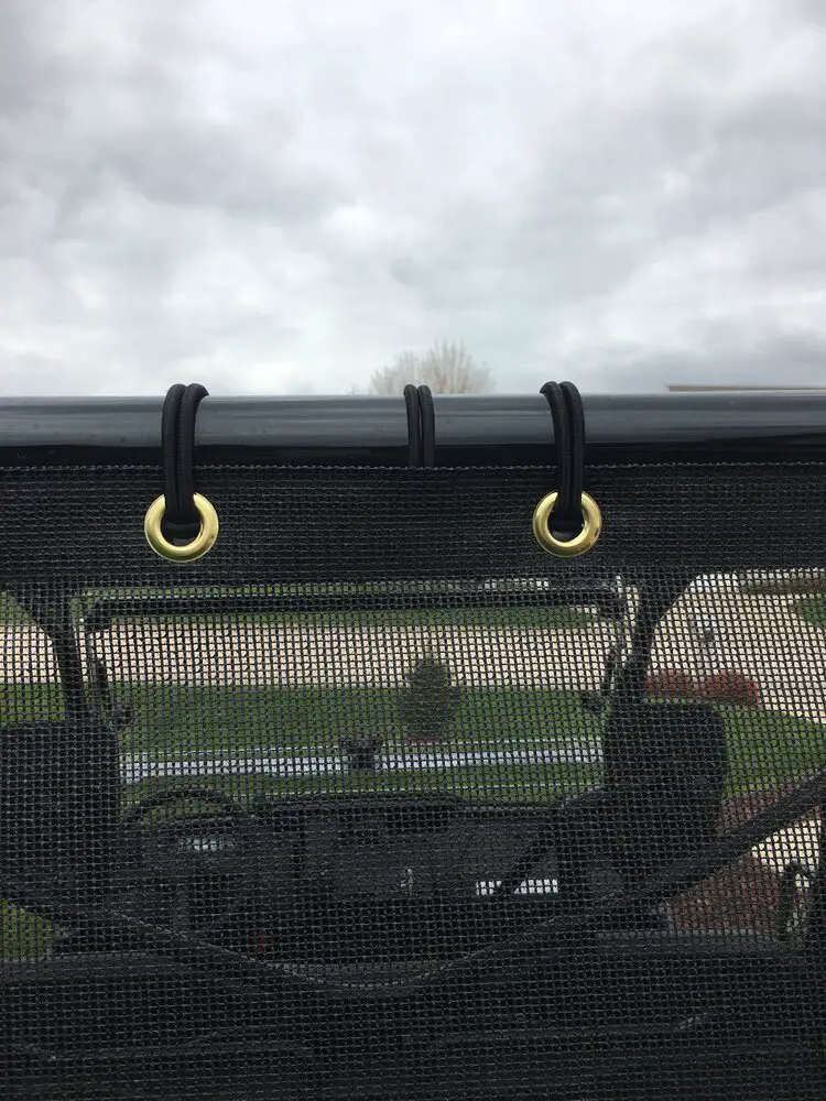

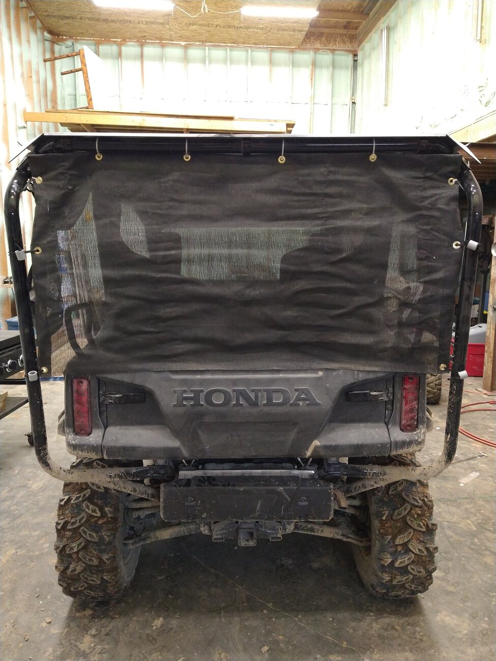

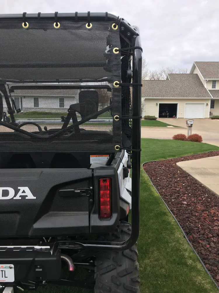

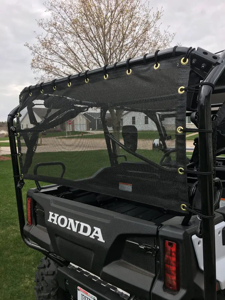

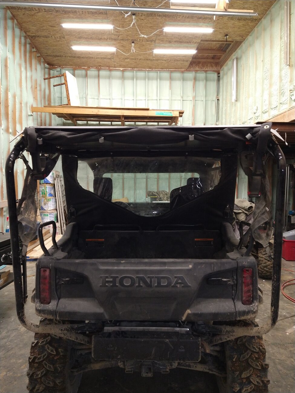

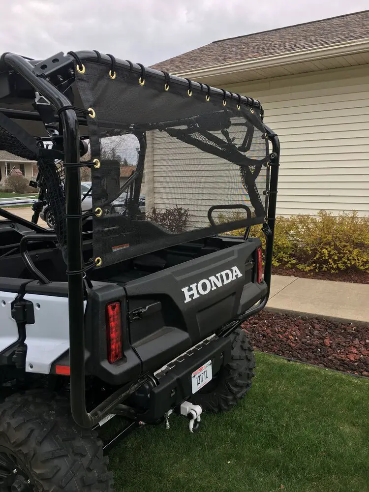

Today was install day. 2 foot high, 4 foot 5 inches wide with reinforce strap and grommets. Special request to leave grommets off the bottom edge. Installed with 6 inch bungees.

Do you think a 2'2" or 2'3" high dimension would have helped make up for the gap at the bottom the upper bungees created?
Sent from my SM-N960U using Tapatalk
Yes, as the bugees pull the top completely to the upper bar, I would have to add to the overall height to close the lower gap. I would have to add however many inches my lower gap is to close it. If my lower gap is, I'm guessing, 4 inches, I may add 3 inches to the height and with 2'3" it would be just above the tailgate.
If someone does not want the gap at the bottom the size of mine, just add a few to the height. I can measure the gap on mine if anyone is wanting an exact number.

Also, I tested the dump bed with this installed, it makes contact very soon and will not lift up. The screen needs to be removed or at least undo the bottom few bungees to have the bed lift.

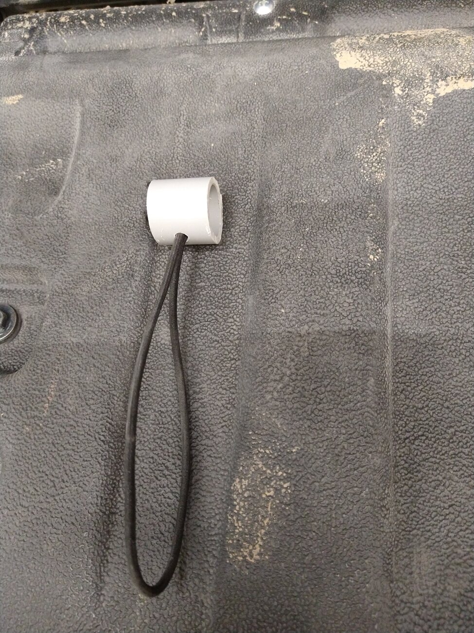

So I wanted to try a mesh panel to reduce dust but I didn't want to ramble $100 on it might help. My 1000-5 has a UTV windshield, tusk roof and Honda Mid-panel. With the kids in the back and the mid panel open the dust can be bad.
I was fortune to have everything for a diy mesh panel on hand: mesh, harbor freight grommet kit, shock cord and wiring conduct. I zip-tied it to the top and used the diy bungees on the side. When not in use, I roll it up and bungee it to the roll bar. It turned out good but I haven't had a chance to try it out.

You got the idea, this is more or less what we have had Coversandall make for us. This last clear one, with the Honda logo and shipping was $36, so if we get it wrong, it's not that much of a loss. But this is even less, good job! The windshield does its job but I am still surprised how much the back of my head gets blown on from behind as I go down the road without a rear panel. Hopefully this helps you.
