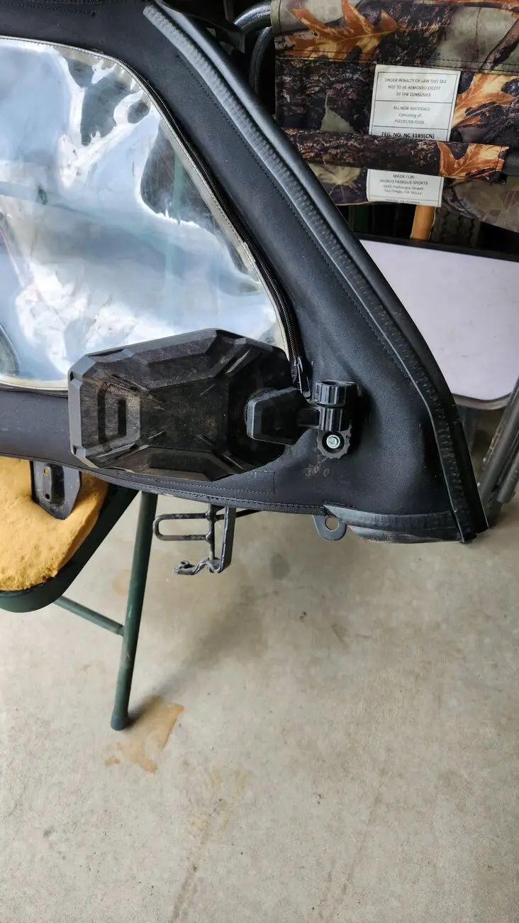

Here's what I did to put mirrors on the Honda accessory doors, welded in some flat stock to the frame then bolted through the canvas.
20230723 170709

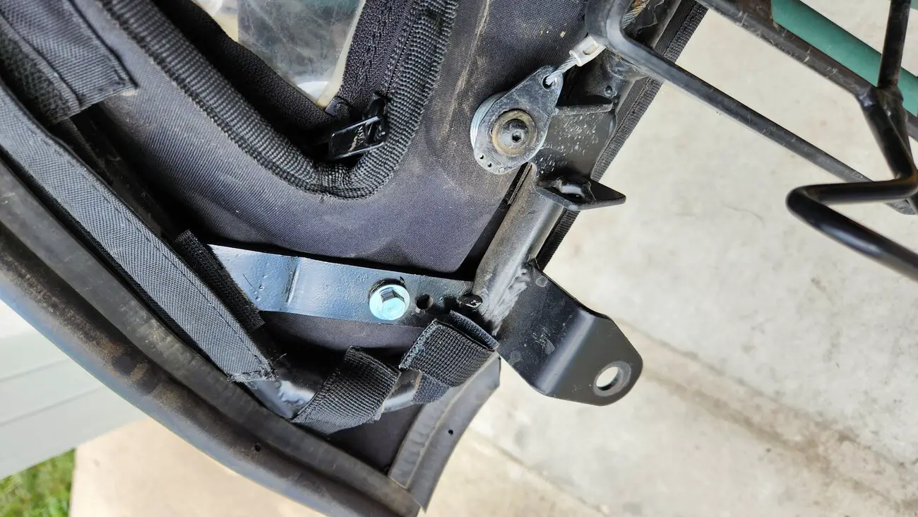

4D039B30 6933 4F29 A016 06B113D36268
Ok so instead of buying flat stock I found two of these. I’ll paint and slap them on and boom, I’ll have my mirrors again. It’s steel so they should bounce while driving and they’re long enough I’ll be able to see them but not too long I’d worry about hitting them on anything. Going to use the bolt for the pod on each side and I’ll drill a second hole to mount the bracket. Only concern would be if I did hit anything with the bracket is that it’s attached to the windshield. That wouldn’t be good.
3DAA52F3 20A1 4EAB A82A ED376B7C46E9
18,415
104,912
View attachment 397102Ok so instead of buying flat stock I found two of these. I’ll paint and slap them on and boom, I’ll have my mirrors again. It’s steel so they should bounce while driving and they’re long enough I’ll be able to see them but not too long I’d worry about hitting them on anything. Going to use the bolt for the pod on each side and I’ll drill a second hole to mount the bracket. Only concern would be if I did hit anything with the bracket is that it’s attached to the windshield. That wouldn’t be good.

Title changed, also had another idea. So I don’t have to drill into the windshield again or worry about if I hit the mirror brackets that it’ll damage the windshield, I’m going to go low on the A pillar and cut the roll bar clamps in half so they’re narrow enough to fit in that tight spot below windshield frame.
CD9691AB 89D1 4668 A574 78902A3E7EA7

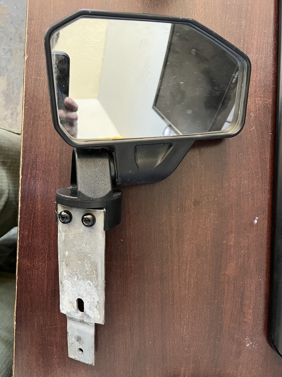

It’s a work in progress still. Need to fix the bracket to fix the angle on it and will play with the possibility of shortening the bracket. As long as I can see the mirror past the enclosure but have the bracket as short as possible. So far the only thing I like about it is it’s not attached to the window frame. The rest I really don’t like, looks stupid to me
8C4CFCA5 20B1 4C06 8675 4995B3CB681B
61656A54 3470 49B0 AF51 337C644D71D9

IMG 4182
Finally finished both mirrors. Not what I want, so I’ll keep looking for an appropriate product or come up with a different solution, but until then this works and doesn’t look stupid. I have a hunt coming up so not enough time to worry about it.
While I was working on it I started adding some weather stripping to keep some of the dust out. This is definitely going to be a work in progress
