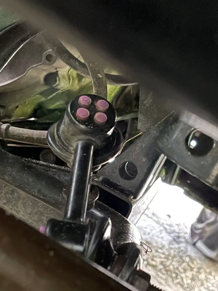

noticed this part is only on one side looks like the other one on driver side fell off
Any idea what it’s called and where to get it ? III looks like it connects to the rear sway bar thanks

A lot of people are disconnecting the sway bar. You might want to try it without it before replacing it.

Thanks so if I leave on side connected and one side gone will that make a difference or just remove the other side too

1 side connected and other gone should work no problem as long as the other side of the bar doesnt hit anything
