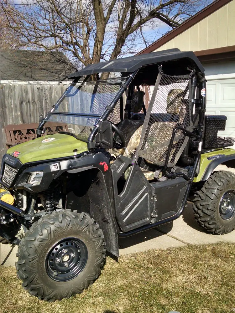

Installed today, front angle bracket behind headlight a pita. Used right angle drill and was able to drill front and rear holes ok. Would have been easier with a helper. Had to get longer bolts due to rocksliders and metal wheel well plate. Nuts and bolts supplied are 1/4 x 20 thread, 3/4 long. Instructions did not match, but they say that due to ongoing design changes. Not too bad. Front comes out to edge of 27x10 tires on 5+2 rims, no spacers. Still need something for rear fender sides. Went with 6 5/8 inches below rear fender, longer bolts helped on inner top fender holes. As requested pics @Chooglin .

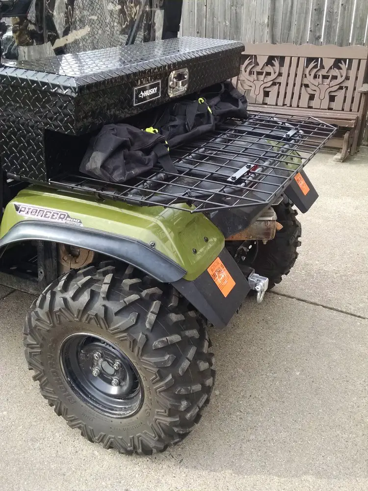

Bought some rubber type mat material from Menard's and made my own.put mudbuster extensions on rear,along with flexiflaresView attachment 70676 View attachment 70675
Just installed new tires and wheels and created a very efficient mud slinger. I have been looking at the Flexi flares. Was thinking about using on front and back. Do you think they will be tough enough ?

Thank you @Mudder they look great and the pic really helps.
