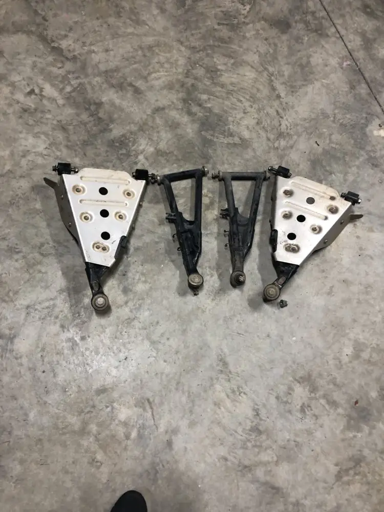

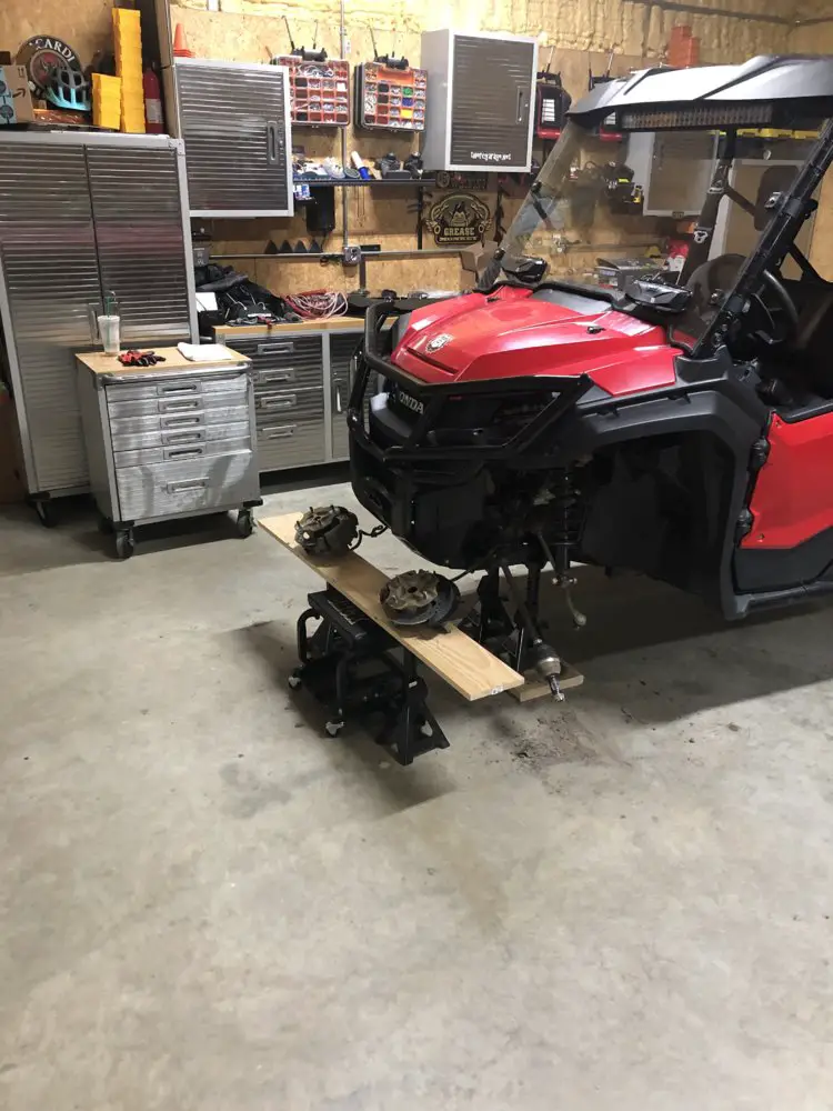

850ish for front and rear with ball joints pressed in from HighLifter. Very heavy duty and beefy setup for sure. I love them
Not too bad, so it will be a pain to replace those ball joints when they wear out right?
No clue about changing ball joints. Never have had to do it but I have a new set of SATV ones on bench ready if I need them. These are upgraded ball joints though not OEM so they should be good for awhile

Yea not anything I would worry about. I'm curious to hear if the machine is any more top heavy with those changes made?

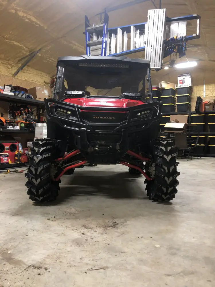

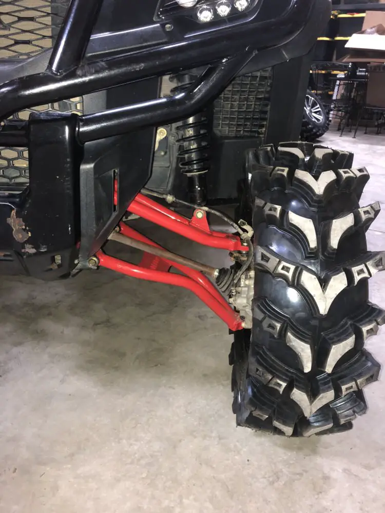

2,846

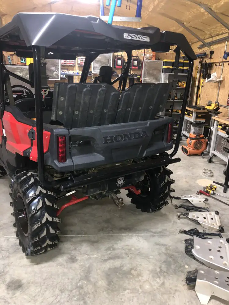

It doesn’t move the tire on the rear so no added tire clearance. It’s just an arched arm for more ground clearance. I have 2” wheel spacers on rear and 1” on front. The front arms are arched and pushed forward 1.5” and I’m running 2.5” HighLifter bracket lift for now until I get the 814 shocks
I guess that means I'll have to get some of those high priced shocks.

What wheel setup are you running because my 31” clear fine in rear. I only did the a arms to get clearance in front.
Wheel offset?
Lift?
Any wheel spacers?
