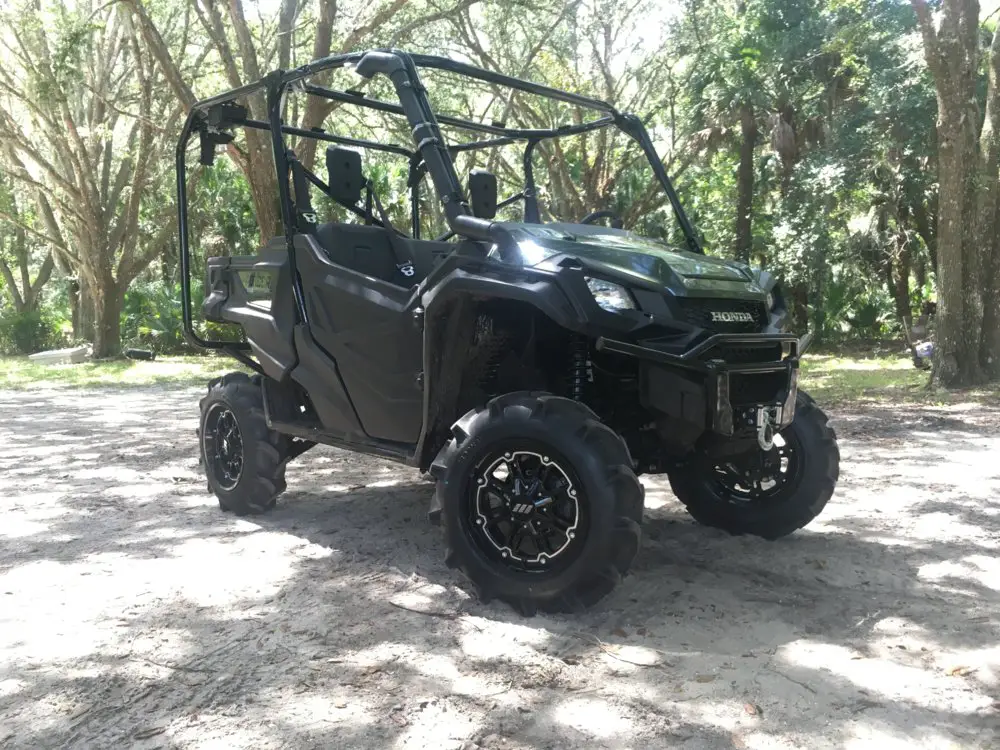

getting ready to the HL lift on my p1000, not sure how I'm gunna like it but I'll post pics when I'm done!
Everyone on here has names for their builds, not sure what to name mine!! So ideas are surely appreciated

How about "The GreenDean"
Welcome here bud. Your vehicle already looks great, in sure you'll fit in just fine.

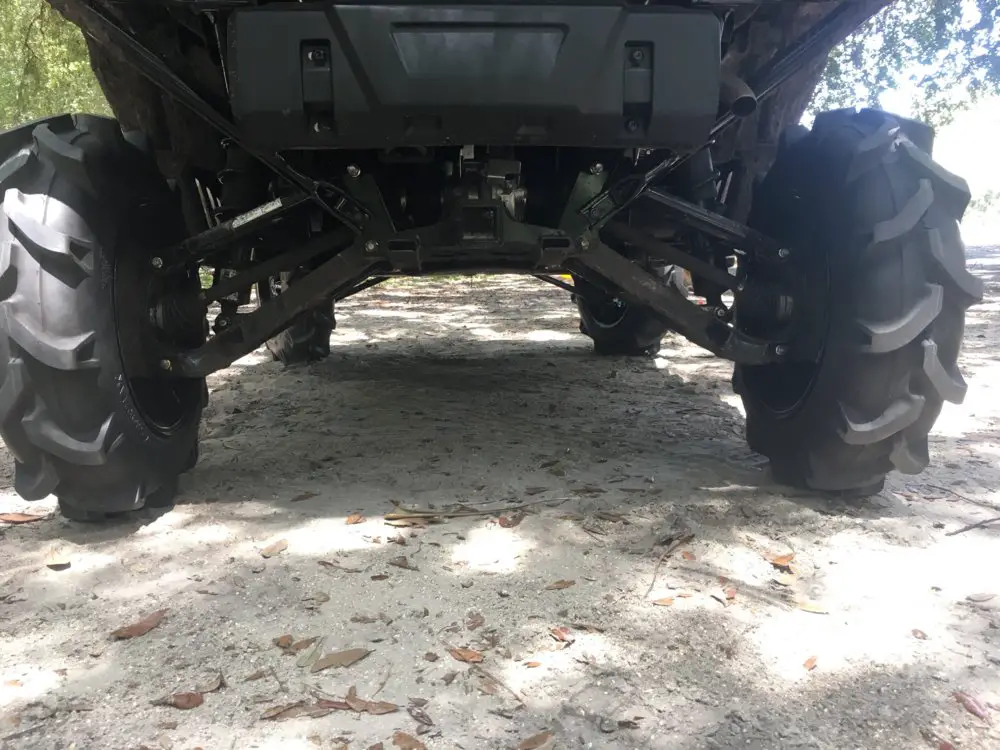

So I lifted the front, originally it was 14" of clearance and now I have about 17 1/4" of clearance and looks to me like the front tires are at a little bit of an angle, anyone else run into that problem?
Reactions: pct
39,129
Yeah, the more you lift it, the more the camber will change. As of now, I don't know of any offset or adjustable ball joints to correct this.

Finished the rear, went from 14 3/4" of clearance to about 19 3/4" of clearance, camber is a little off, but I think I'll ride it as is and try it!

View attachment 20516 View attachment 20515 Finished the rear, went from 14 3/4" of clearance to about 19 3/4" of clearance, camber is a little off, but I think I'll ride it as is and try it!
That may be the smart thing to do. Ride and see if it settles down.
As you add accessories, that should also compress the springs and level it out some too.
