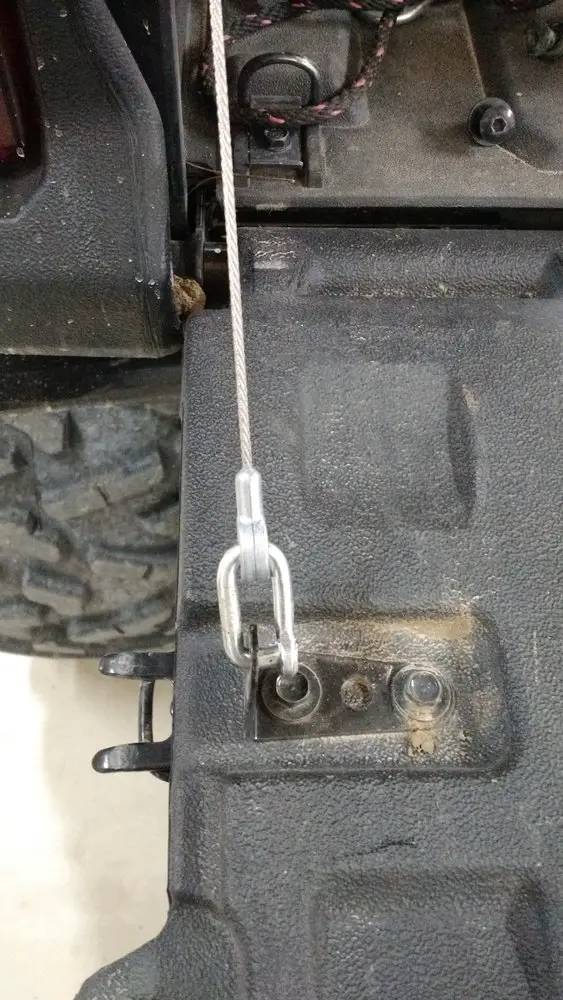

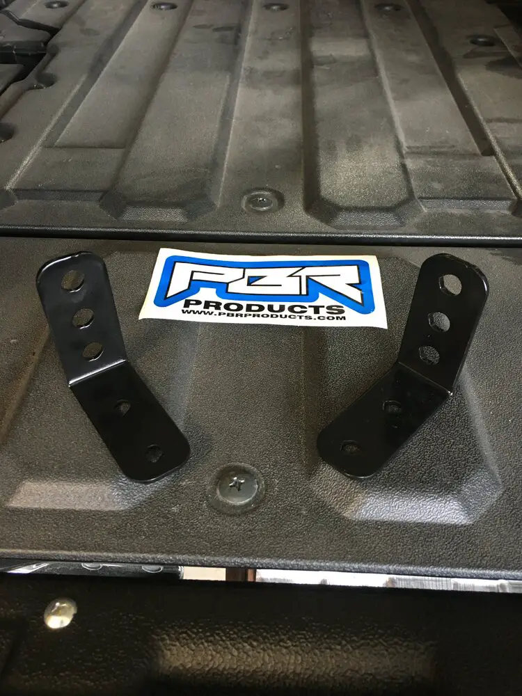

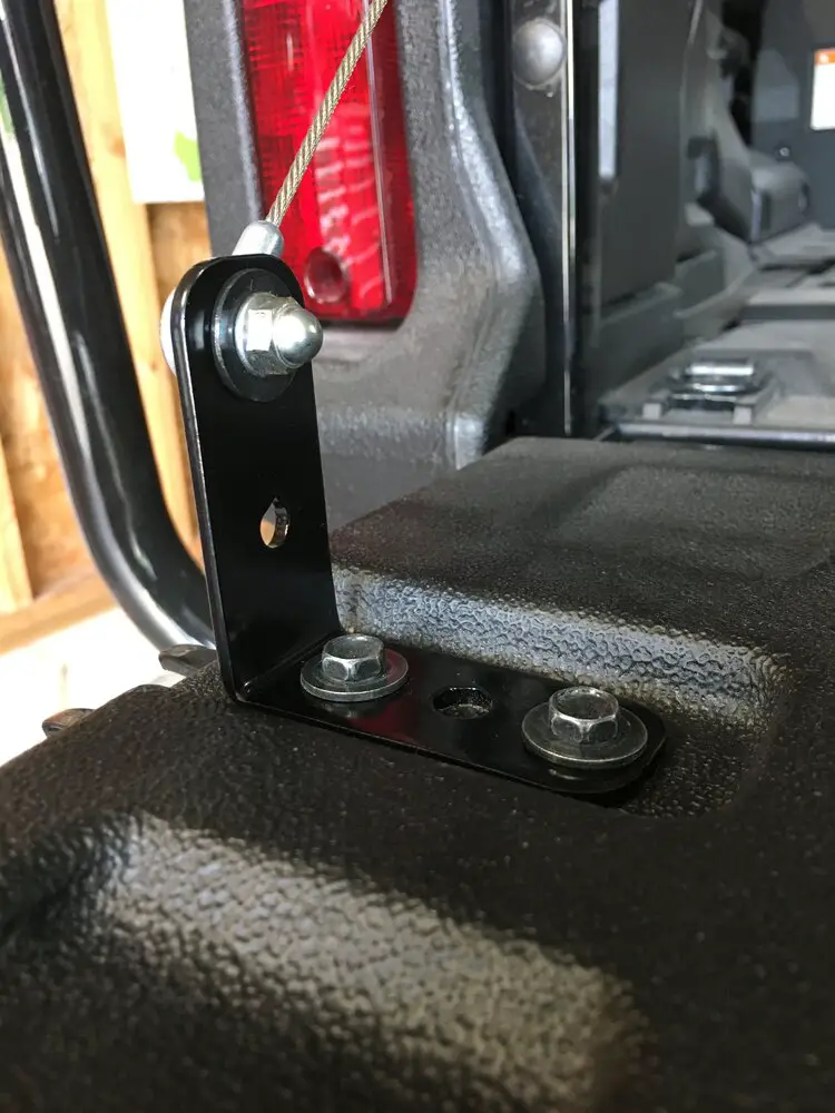

While on this topic, I had installed brackets I purchased from PBR Products. They are well made, and I installed them with no problem. But after they were on, the tailgate end of the cable does not rotate on the shoulder bolt that goes through the bracket. I think I can tell, that the powder coating on the new brackets is thicker than the factory paint/coating.
So the shoulder on the shoulder bolt used to tighten against the bracket and the cable end would pivot. Now, the shoulder bolt is holding the cable end tight against the new bracket. I close the tailgate and the cable is in some weird loop. Very minor I know, but I may have to file the cable end a slight bit thinner so it will pivot. Or find a thinner washer?
View attachment 325723 View attachment 325724
l would just shave a little bit off the eyelet. lt's not gonna hurt a thing. What will hurt is your cable bending funky all the time, then it will get brittle and snap.
