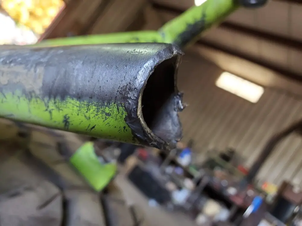

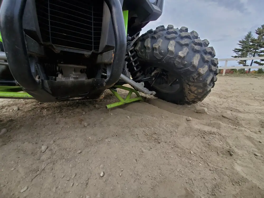

Not a fan of L & W anything.......
Resized 20200927 171100
Resized 20200928 100538
Zero penatration on their welds resulted in major damage to my buddies Talon after the arm snapped. They sent him some new parts to fix their screw up but only replaced the arm that broke. I guess they were confident the others were good....... I wouldn't trust any of them personally.
View attachment 239293View attachment 239294
That sucks! Maybe a fluke, maybe not. Been beating on mine on a 4 seater without issues so far. I kept my stock arms as spares.
