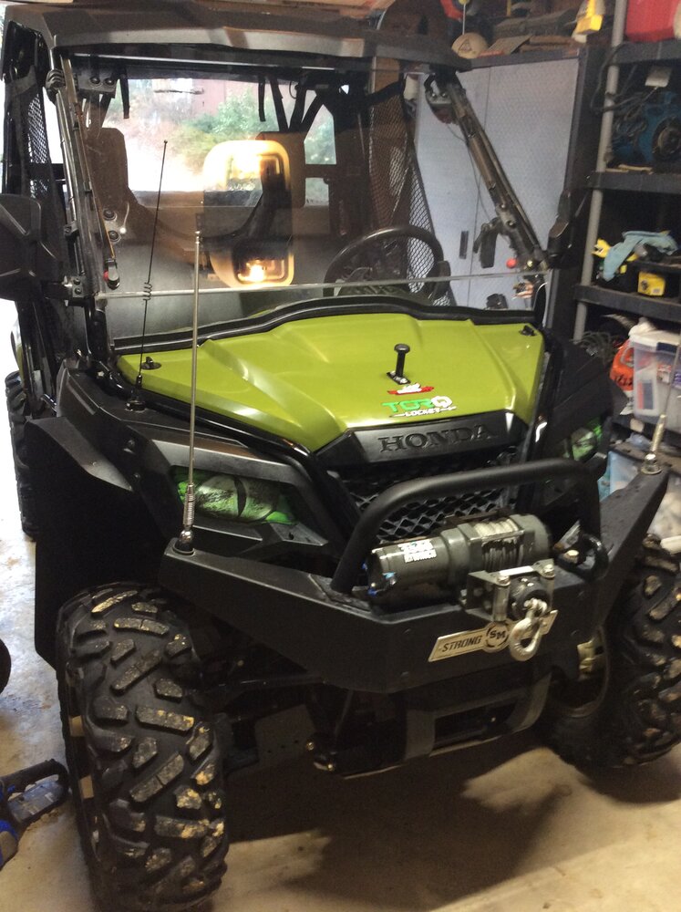

Welcome from Ga. I recommend a Strongmade Bumper and mount a winch directly on top. The top mount is nice if in a mudhole or for plowing. Very durable. Also suggest the honda sub harness for 4 key on power sources, which one can be used for a winch key-on relay power. I’ve been running a Harbor Freight 3500 winch off the single battery with no issues. Generic wireless winch remotes can be found for $20 and are a nice addition. And of course a rubber @trigger shield to cut down on heat and noise.
I used the Honda harness for my winch switch to relay, led light bar (P5 headlights suck even with led bulbs) and a horn to be street legal. All without splicing into existing wiring.
Off topic but what is the black 4-6” tall object in the middle of your hood?
That black thing is a threaded knob to secure the half shield when folded down.
