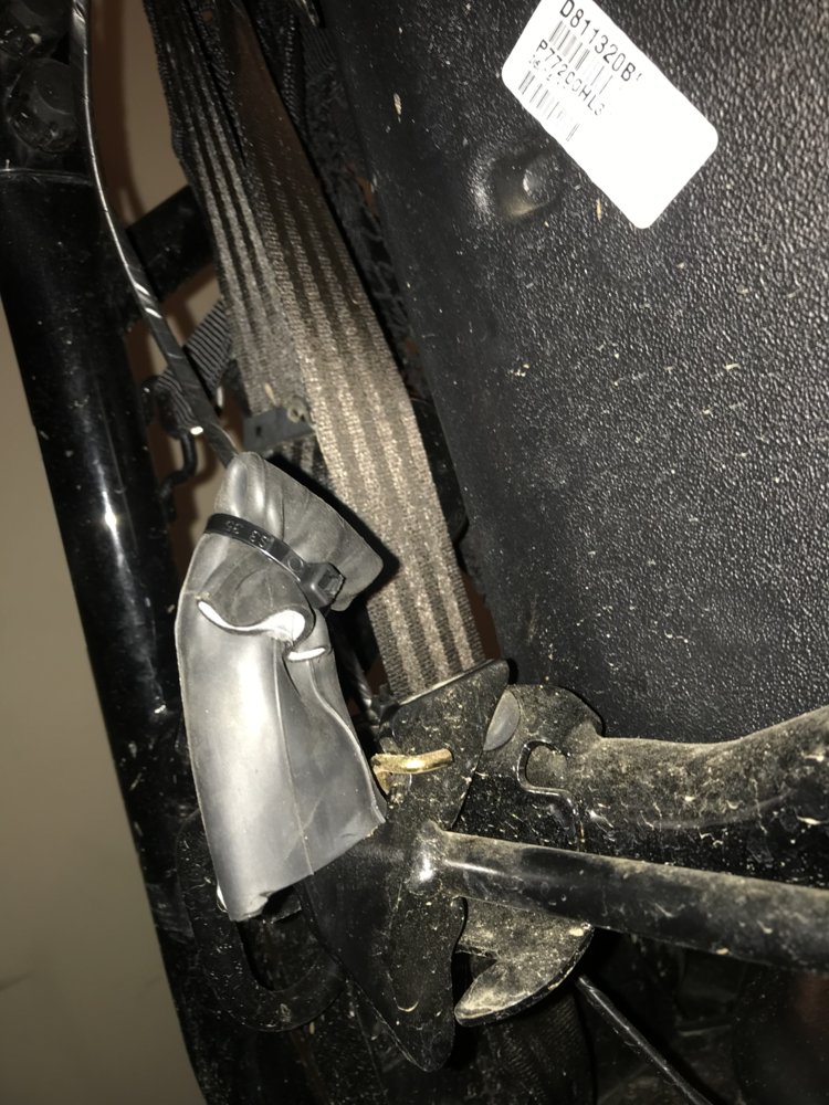

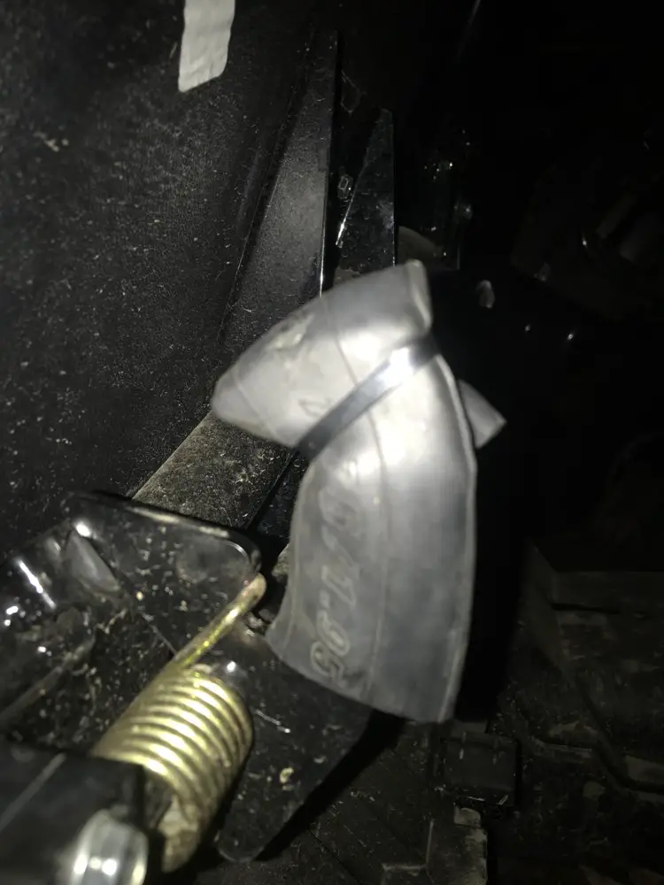

I am pretty proud of this fix I came up with... Bought a thick bicycle inner tube and cut it to length.Put it over the latch and fold the excess over (you want the excess)... zip tie it tight and no more noise! When you dump the bed with this on you need to hold the dump latch up when you put the bed back down or the other side will cut the rubber... works great!
View attachment 97374 View attachment 97375
Genius! Any ideas for the doors? The driver side isn’t too bad because my leg usually rest up against it, but the passenger side is brutal.
