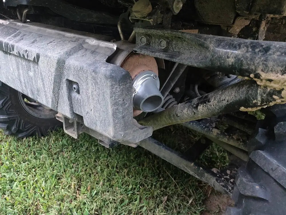

I just installed mine and love it! Thank you all for all the information you provide! Stuff like this makes modifying so fun!

I just changed mine also, and don't really notice any difference.
I notice a tone change, not a volume change. The machine sounds deeper. I like it. While I was doing my research on the pioneer exhaust I came across the whiskey bent tip. By its description and others remarks I wanted to try it. But $100 for a tip with spark arrestor seems really steep to me. I found this thread and I was able to try out the tip change for $22 with spark arrestor. I just hope soon to drive my pioneer enough to change the tip color so I can be like the cool kids.

I would say it's not any louder. While driving you can't tell a difference from the seat. Those around you will hear a difference. My wife described it as sounding less like a ricer.

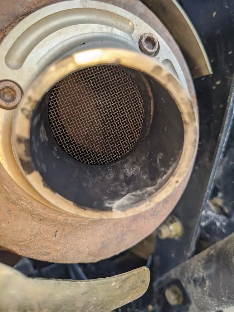

There is no way that the screen included with that tip had any sort of effect on the sound/flow/etc. The mesh is way too big to have any sort of restriction. The only time I notice mine is when engine braking and it has a little rumble.

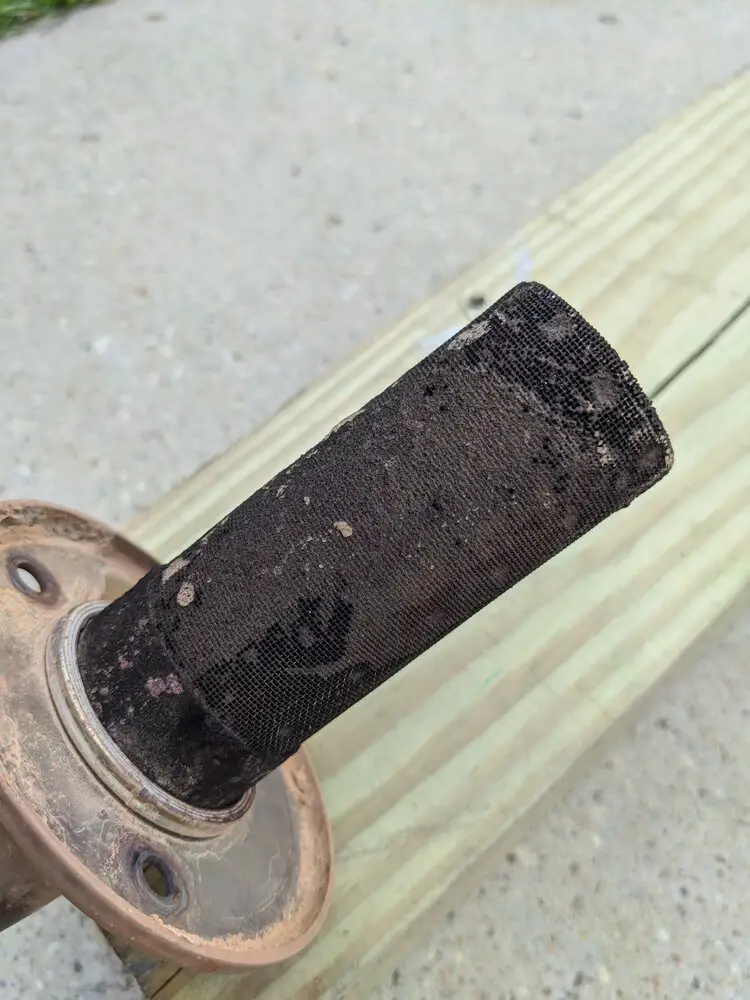

It's not like the stock arrestor that juts way into the muffler with a much finer mesh. Mine was clogged to the point it sounded like something was stuck in the tailpipe.

Honda extends the screen into the muffler for good reason, as it allows the screen to have far more open surface area, which equates to less restriction (assuming the screen is reasonably clean of course). The smaller flat screen, even though it has larger openings in the mesh (good), has larger wire diameter (bad) and less screen surface area (also bad). Without doing the math or setting up a test rig with manometer to measure the delta-P (pressure differential across the screen), my guess is the aftermarket screen probably has higher restriction.
The takeaway, is add screen cleaning to my maintenance interval. :)
