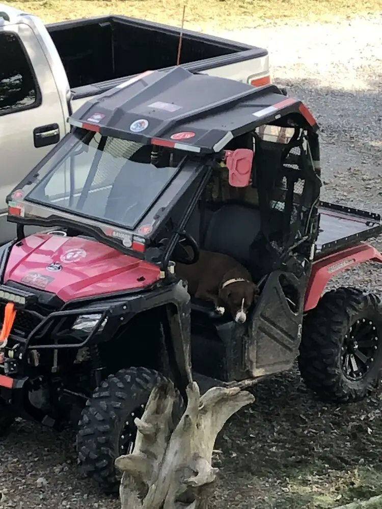

OK, a 2 year update. The glass windshield has been to Colorado for 2 weeks last year with temperatures in the low teens and Arkansas summers of up to 105. Lots of rough miles and high speed trailering and the glue is still holding perfectly. The windshield glass has not moved at all. At this point I'm going to call it good and feel confident in saying this will work.

IMG 1222
4 years now since I started this and the windshield is still good, glue has held through yearly trips to Colorado and all the bumps and limbs here in Arkansas. Temps from near 0 to 105 degrees. There has been absolutely no movement in the windshield glass glued to the plastic windshield.

Thanks for the update. Curious what a driver’s view pic looks like.
