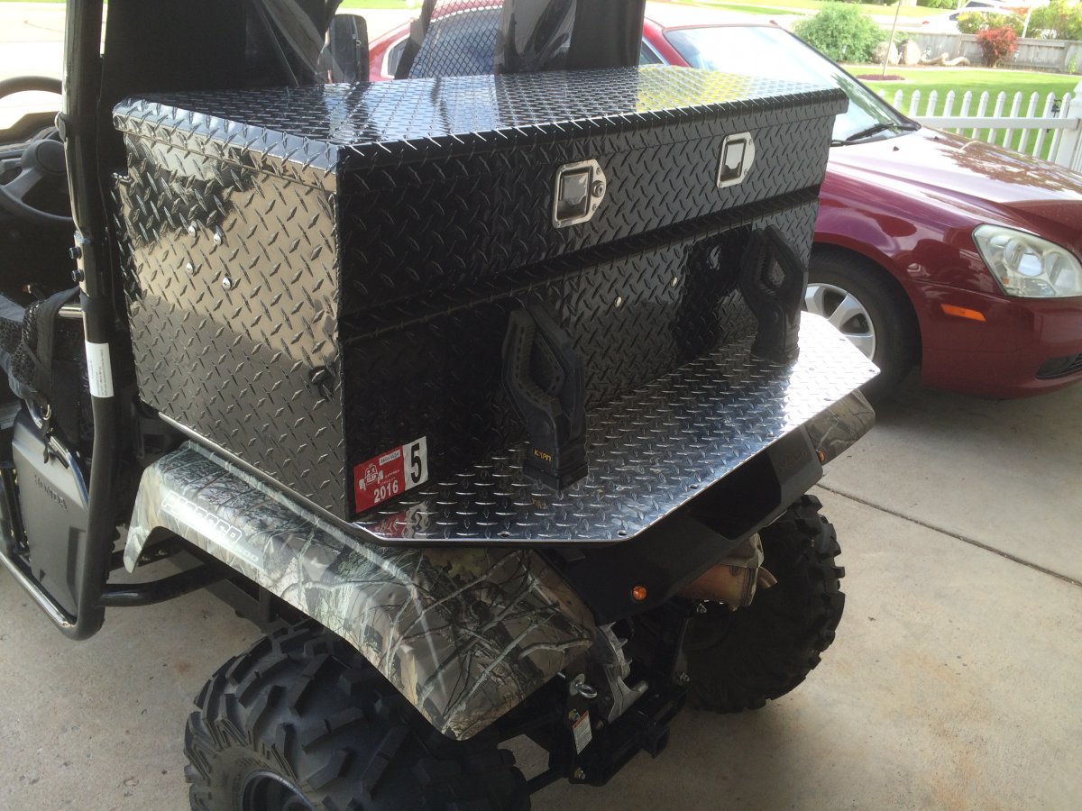

Finally got around to doing something with that wasted space under the seat. Had enough old vinyl covered aluminum to make a box about 5" inches deep.

What's the best way to fasten it to the rack?
Made a bed out of 1/2" plywood that fit the rack dimensions. Then I used nuts and bolts with lock washers in front and back
where I could get a wrench in there. Self tappers in the middle. Take a look @JACKAL P500 build. That was the starting platform for what I did,
then just put your own twist on it. Jackals build should be the mandatory first read for anyone building a P5...
you'll pick up a ton of ideas and info there. He didn't get the title of ancient guru for nothing.
Sweet sounds like I'm gonna start a project lol. Thanks for the info.

I mounted a box like yours, at first I had it all the way forward against the cage. I noticed the noise level increased a bunch. Glad to see you moved it toward the back. I ended up doing that

I am not meaning this to sound like its a bad thing, just trying to help.
Have you ever considered using the rubber Jeep hood hold down "thingy's" to hold that box on. Should mount up very well and allow access to that box when you need it.
My box is mounted as close to the cage as possible while still opening.
Have a sub mounted in there...
250 watts and that noise level goes away!! :D
