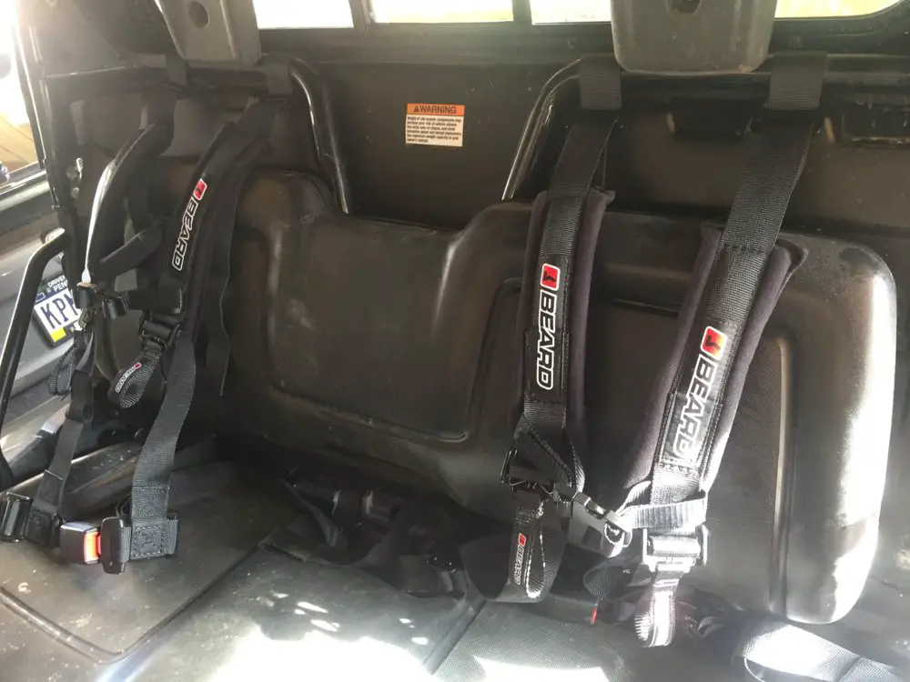

Do you have any problem with the harness straps slipping down the inner bars?
I just installed them yesterday, so I cannot comment whether or not they will slip while driving and strapped in. I envision them slipping down possibly when not in use. When I strap myself in, and started adjusting, they did not move. I think I'm going to somehow clamp on either side of the strap. Like a pipe clamp, or something.

Just an update on the Beared Harnesses. They do slide on the bar, when in use, and when not. Easy cheap fix, Tusk Harness Retainer Straps! All you have to do is take the head cushion off, and grind a slot into the cushion support. Easy peezy, and the harnesses are locked in.
