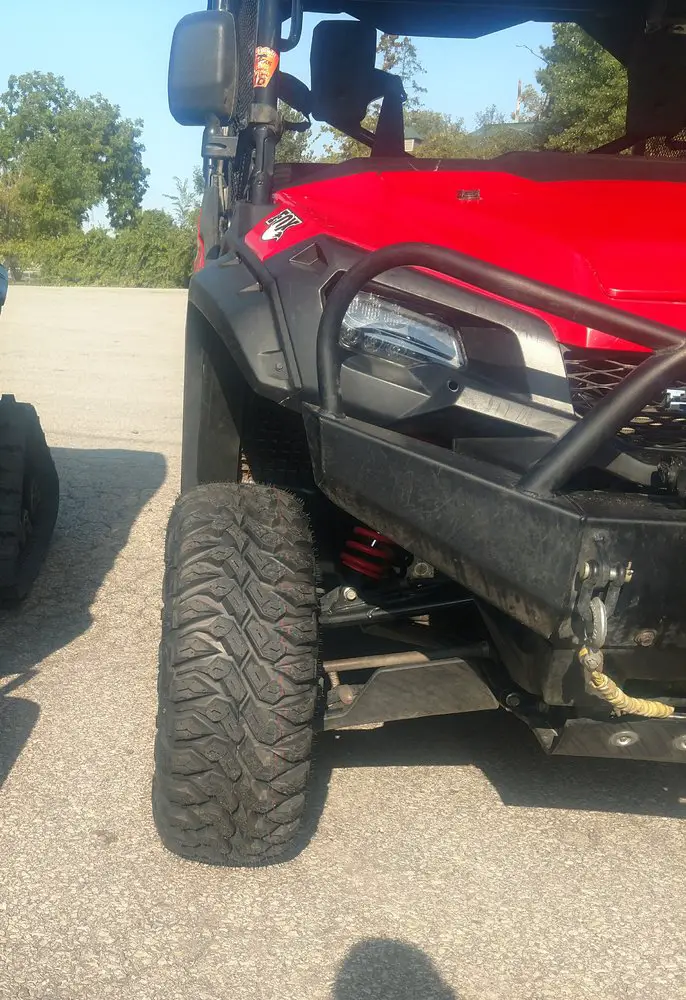

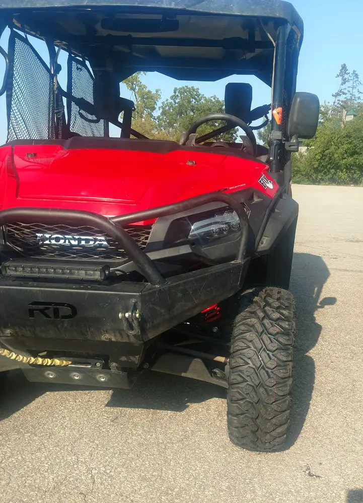

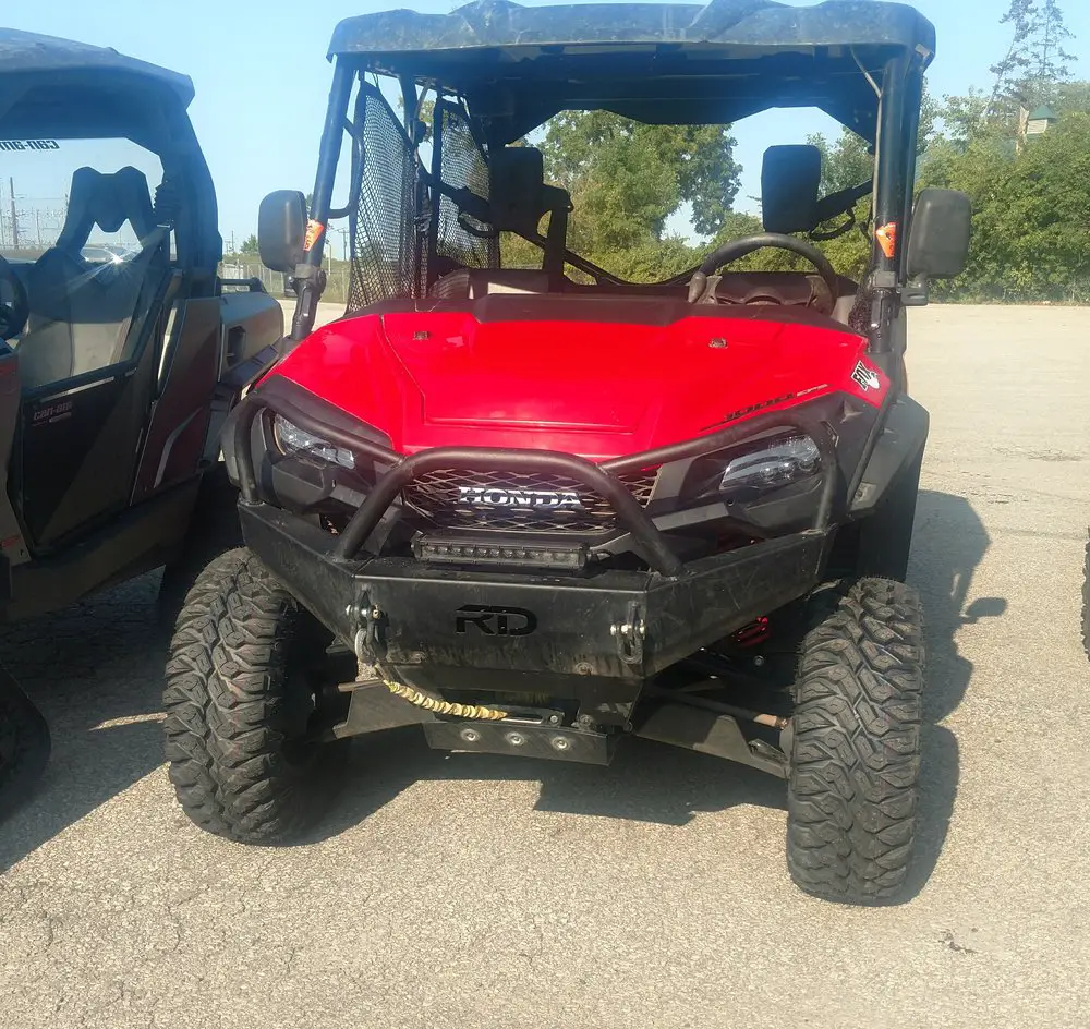

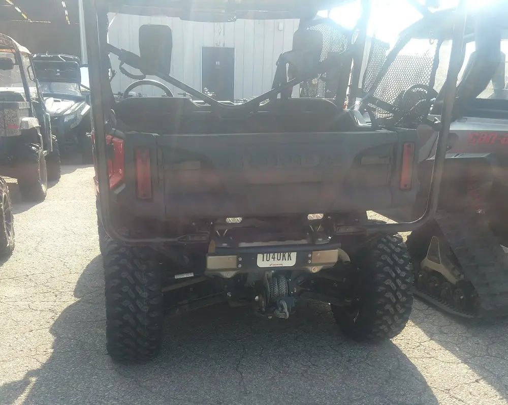

Got my 28x10s installed today. Quadboss qbt846 on stock wheels

Nice! Soooo.... what do they measure?? When you get a chance please.
I just did a walk around at the dealer and the machine is still there for service so I don't have specific dimensions but visually the rears look the same size as stock and the fronts look taller and wider by a little. I should be able to get a dimension later this week
