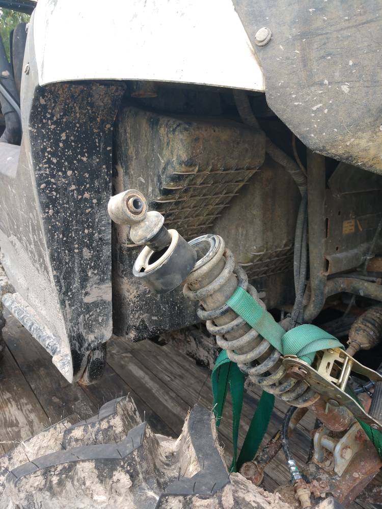

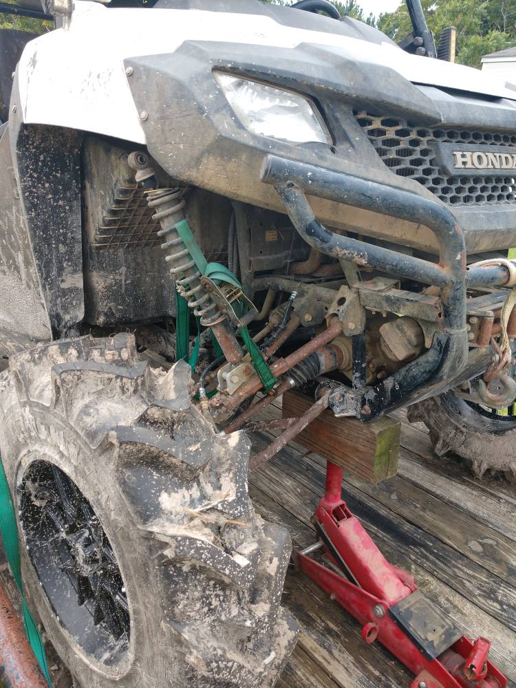

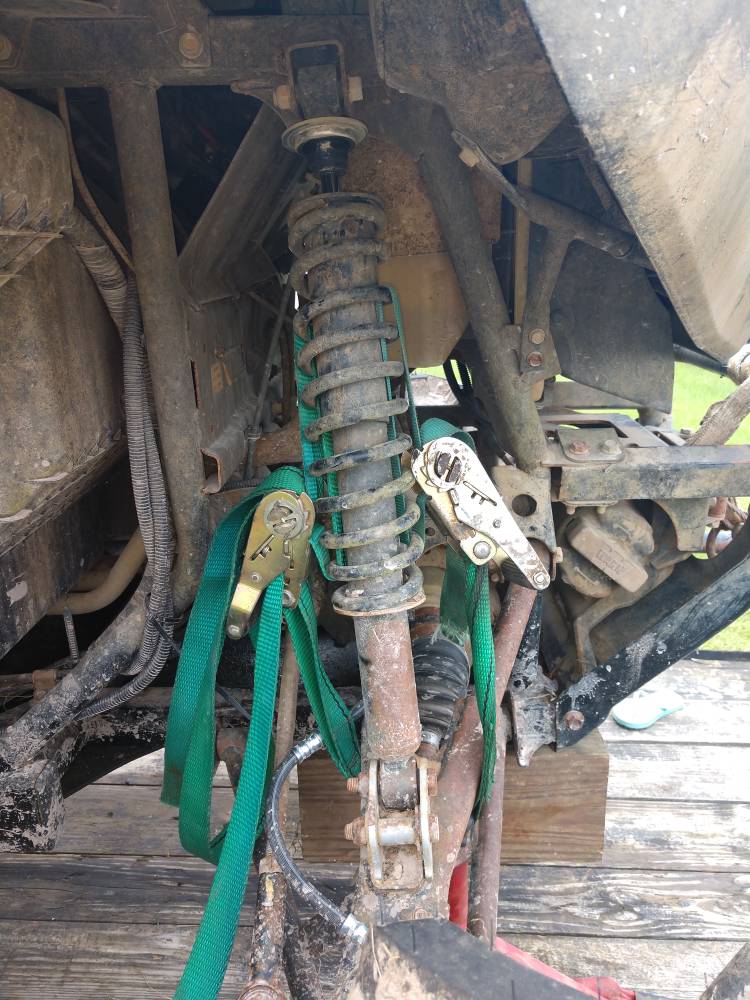

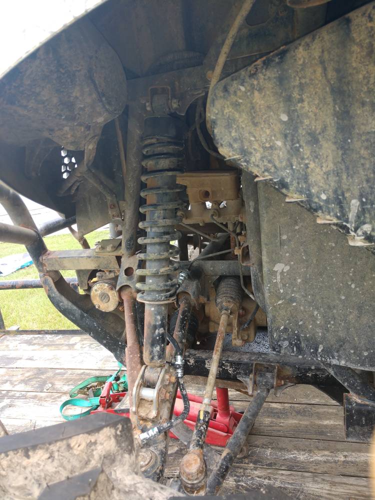

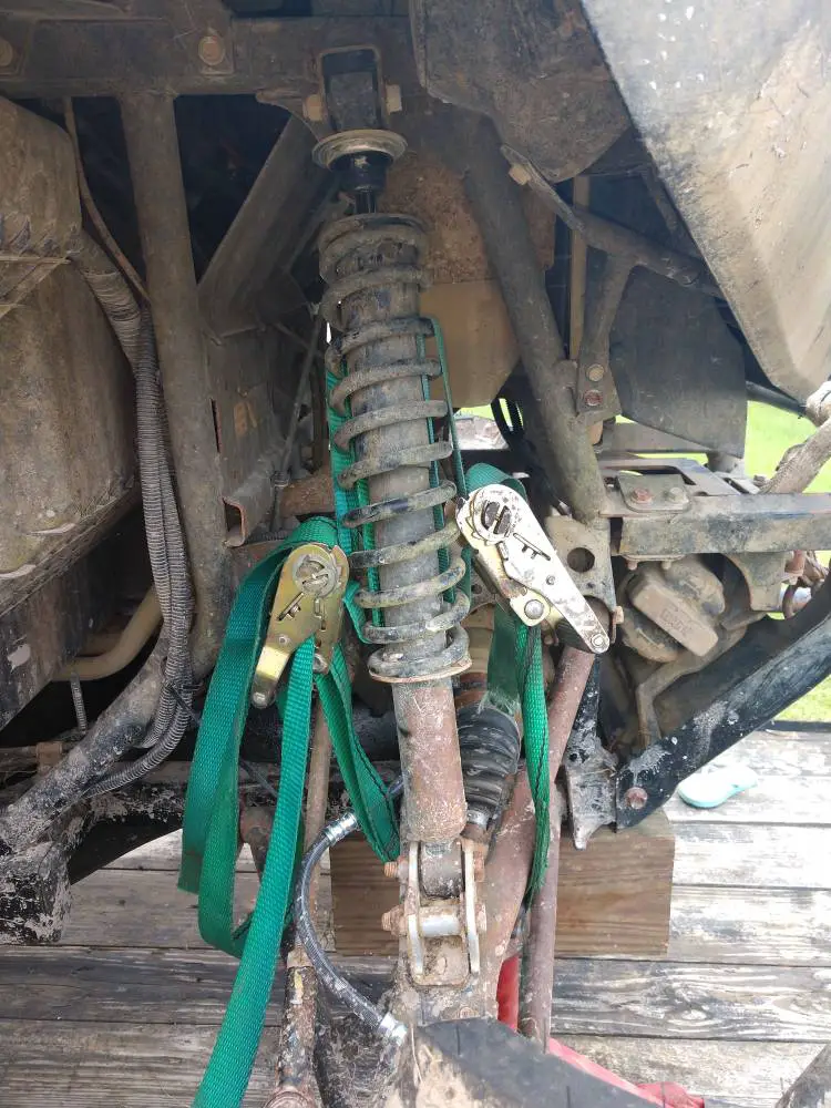

easiest way to install is to use a ramp pull 1 side up on it to compress spring a little then use 2 ratchet straps on opposite sides. back it off the ramp and jack it up. itll give you all the space you need to install 2da25c71923412c150e6a0f728497925B5c456d975fb03433dafb440ae3cb1212c27444115178791ca36ed46b22241cb880b9b37e2b5273ffe6fce383b10dbf3

easiest way to install is to use a ramp pull 1 side up on it to compress spring a little then use 2 ratchet straps on opposite sides. back it off the ramp and jack it up. itll give you all the space you need to installView attachment 149278View attachment 149279View attachment 149280View attachment 149281
Great info and photos, much appreciated that you have save me install time with the ramp trick. I am going to order a set of spacers today/ Looks like there are black composite and aluminum to choose from.
