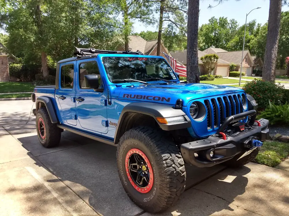

Like I said, I'm kinda a visual guy, so the picture is my DD.

Welcome to the forum but that there’s a Jeep. Ain’t no pioneer....pictures please, or it’s as imaginary as all my friends...

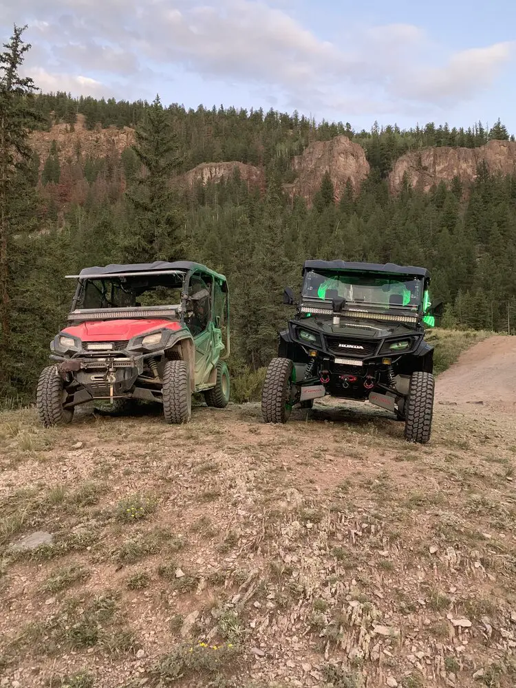

No issues with 30’s and stick gearing. You will need some forward arms like the SATV arms for example, and a set of spacers won’t hurt. That’s the set up I have.
Mine is on the right @100Acre is on the left

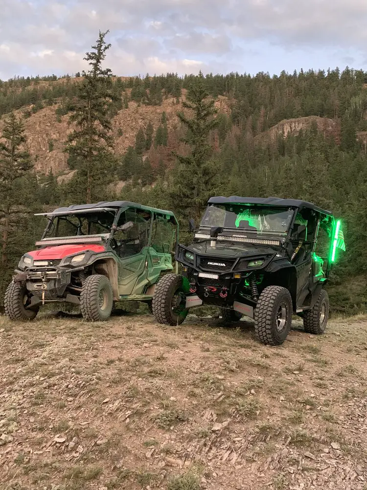

Depending on the mud you’re playing in you might want an IGR and a tune the canned Dynojet tune should be fine. The “peanut butter” mud we have around here that is basically sticky wet clay will hold on to anything that you put in it. The looser silty sandy stuff shouldn’t be a problem for stock with 30’s.
CE03AB86 FD64 4519 8E56 B0DDB4E10E86
This was my setup with SATV with 30’s, if you do the SATV arms go ahead and contact “garage products bushings” the SATV bushings are crap. You will also want to add weld washers around the upper a-arm holes and carry a spare a-arm bolt the factory arms use a rubber bushing that absorbs impacts but the SATV uses a hard plastic brushing that does not. It puts a lot of wear on that bolt hole and bolt.
You can see in this video what ⅛ of wear on the bolt hole does.
