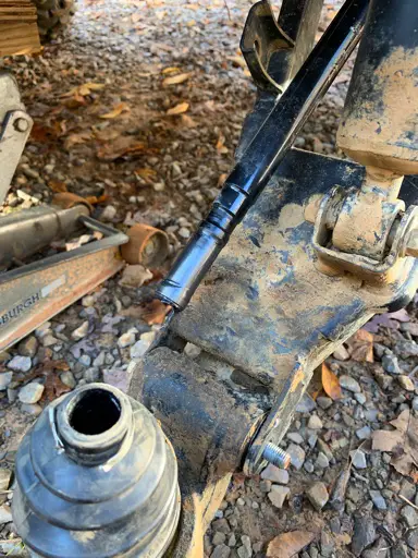

Will be running a niche axle for the replacement of the drivers rear that I had broke the splines right at the outer joint. Axle looks well made and has a 2 year warranty . I am running 1 1/2 spacers EVO blackwater 27” tires and can am shocks . Will see if these axle holds up .

Well took the axel out this week end . I haven’t removed it yet to see what actually failed . Will be testing the 2 year warranty.

Stock axels are really good . I did get the broke axel warrantied and should get it in a couple days . The stock axel broke the splines off the end , the joint didn’t fail. Have 1700 on mine on ya I beat not it hard. I actually took out both left side this weekend . The front was a all balls 6 ball. The right front I up graded to the all balls 8 balls and so far it is holding up. I did find the bind that full lock puts on the front axels are a sure to break if you try and turn hard while using the lock.

air pressure has alot to do with turning breaks. im still on stock axles and ran 27s for the 5 yrs. now on portals with 32s and only problem iv had is portal brackets cut a boot. everything else is like brand new.

So the joint didn’t break the axel did . Niche did send me a replacement as soon as I filed the claim. The stock axel did the same that I broke. Run can am shocks and 27” blackwater EVO’s .

id say use some limiter straps on the commander shocks but that kinda break is more inertia style.
