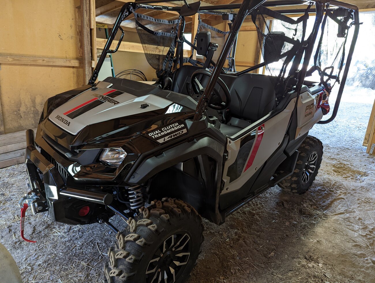

I have a 2022 1000-3, Honda roof, and SATV flip up windshield. The roof and windshield fit on mine. When the windshield is fully open, there is about 1/4” between the front middle of the roof and the windshield. It will tap if you are bouncing the machine around. If that bothers you, the front middle portion of the roof can be trimmed, and as another forum member pointed out on another thread, you won’t miss it.
