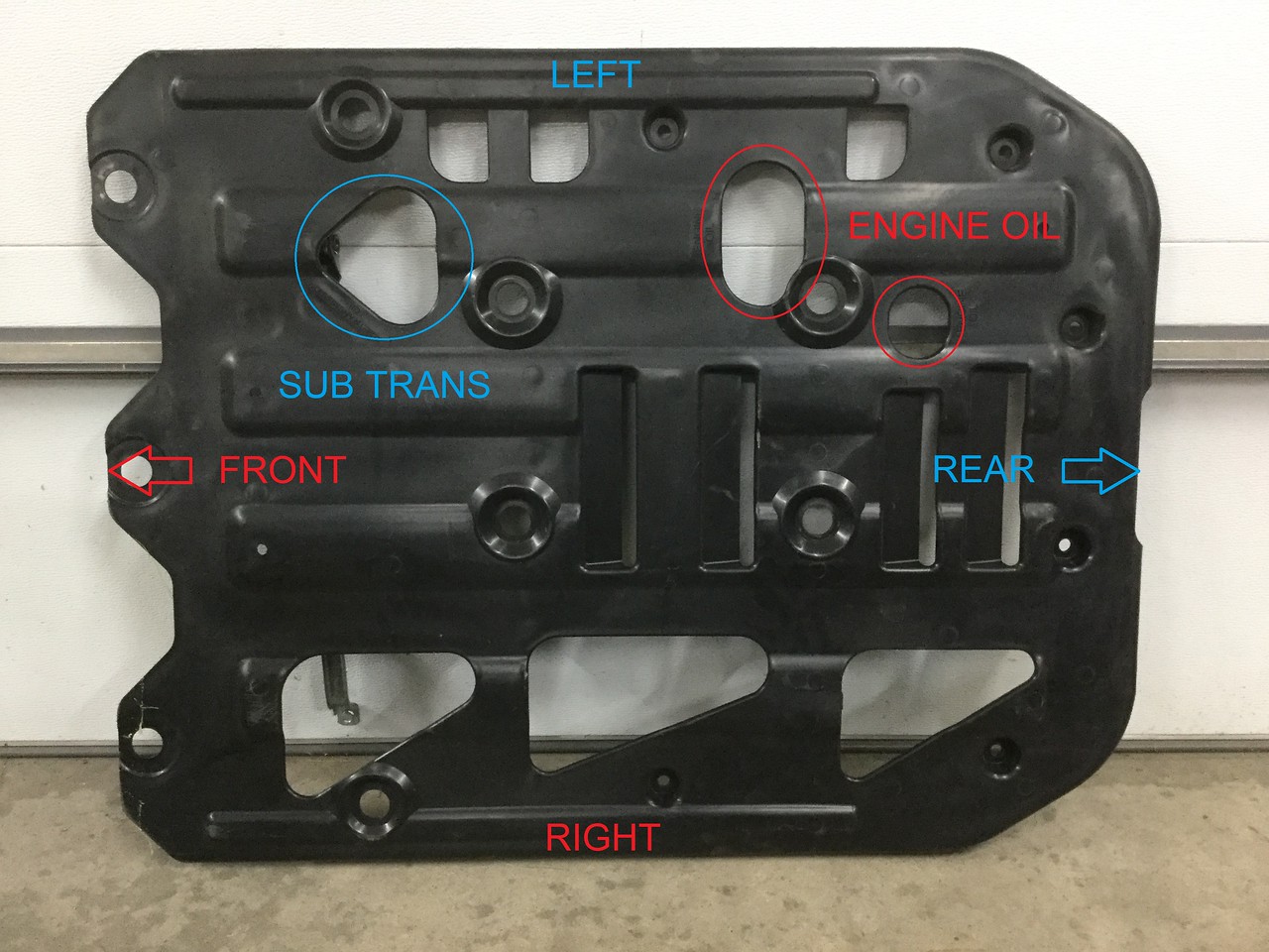

If you aren't familiar with the Pioneer 1000 - the engine oil has two drain plugs about 4" apart, one is horizontal and pointing to the left side. The other, and a little rearward, is pointing almost straight down. You'll want your extension leaned a little bit to the right side so you don't round off the drain plug - no, you're not crazy. (at least on a Talon, I'm assuming the Pioneer are the same)
The sub trans is forward of those two and also points to the left side.
This is a Talon skid, but the drains are in the same place (very similar engines) -

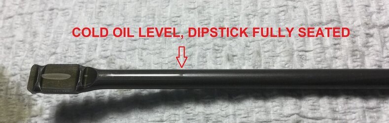

Honda's recommended procedure for checking the oil level is ridiculously unrepeatable IMO.
It reads -
18. Start the engine and let it idle for 3-5 minutes.
19. Stop the engine and after 2-3 minutes, check the oil level. Make sure the oil is between the upper and lower level marks on the dipstick.
When I do an oil and filters change, I add 6.1 qt. per the manual and never look at the dipstick. 1/10th qt. is 3.2 oz. - so 6 qts, 3.2 oz.
I never use the ridiculous Honda procedure of warming up, shutting off, waiting for 2 or 3 minutes, then check oil level. WTF? I do an oil change, run the buggy long enough to saturate the filters, shut off, wait (sometimes overnight) and then check the oil with the dipstick fully seated - like you would before a ride or when sitting in the garage during the week. Idjits.
Right after an oil change, running long enough to saturate filters and letting sit. Do this with your own engine, with the buggy sitting in the same place you'll check it in the future, don't use my mark. You get to decide if you want to get your reference mark with the dipstick screwed in or not. yada, yada, yada, YMMV, IMHO :cool:
