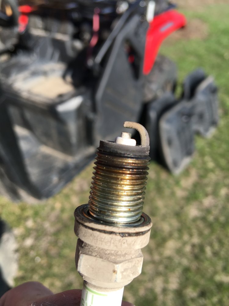

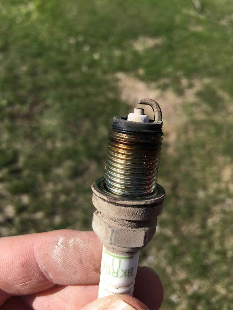

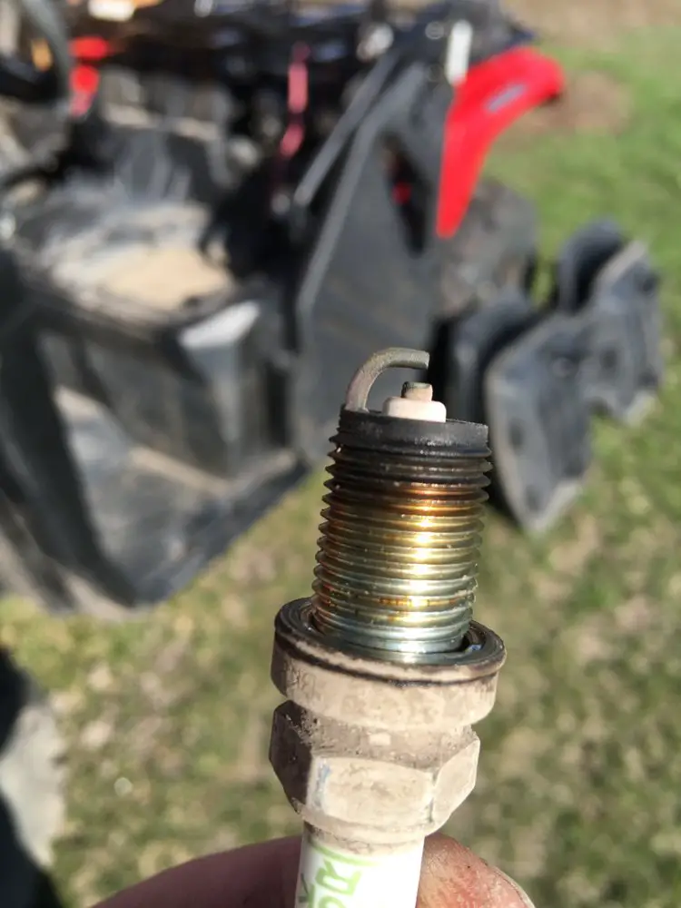

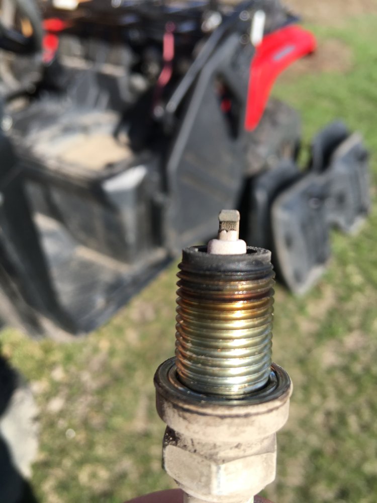

Pulled the plug tonight and hers what it looked like. Also watched for any smoke from the exhaust and nothing. Getting my oil and filter Friday will change it and keep you posted.
View attachment 14239 View attachment 14240 View attachment 14241 View attachment 14242
Plug looks great, you're not burning any oil. You have no worries. Perhaps you have a small leak that's staying atop the skid. Or, perhaps after this oil change, you'll see no more trouble. Like ehart told you, always check oil the same way.
