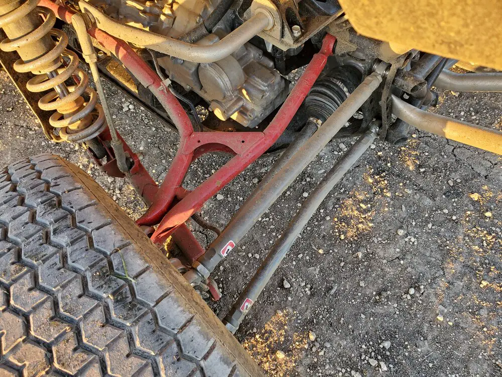

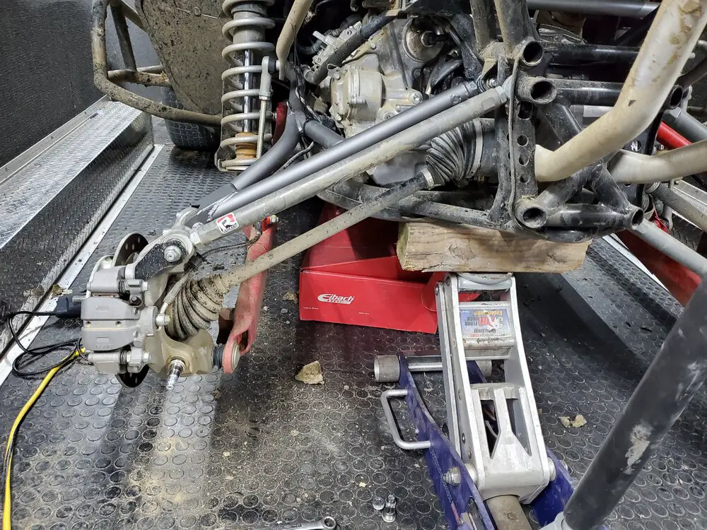

Got back yesterday from a great weekend at Wildcat Offroad and found my stock passenger 4th link with a slight bend that is making my tire track off a bit. I've been super happy my ORB radius rods and lower front a-arms so I went to order the 4th link today but when I asked if they have mounts for the brake lines I was told "No, you have to use zip ties". I'm a little hesitant now, especially considering sections of the line are rigid tubing rather than hose. Anyone with ORB 4th link? What did you do to secure the brake line?

That's just a baby bend........

I replaced mine with JSport arms. Theirs have provisions for the hard line welded on but I decided to zip tie them to the arms instead of taking apart the lines to mount them correctly. I've had zero issues. Yes, I'm lazy!

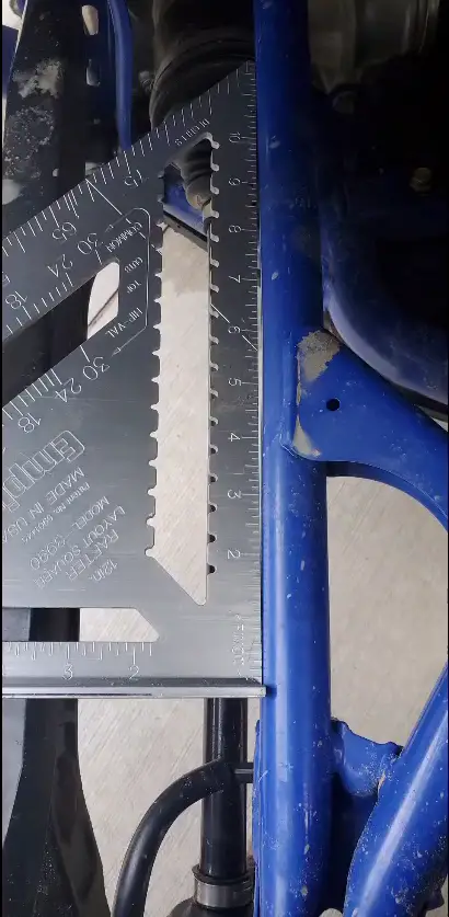

I agree mine is not that bad but, it is bent and now I have an excuse to upgrade! Plus I have some movement in the knuckle mount bushing. I understand how they could bend they way yours did, however I'm surprised with the gusset location that mine bend inward.
Glad to hear the zip tie method is working so far as I may go that route or just order the ORB arms raw and weld on mounts myself. I like the JSport ones however can't see justifying over $300 more for them vs ORB.
