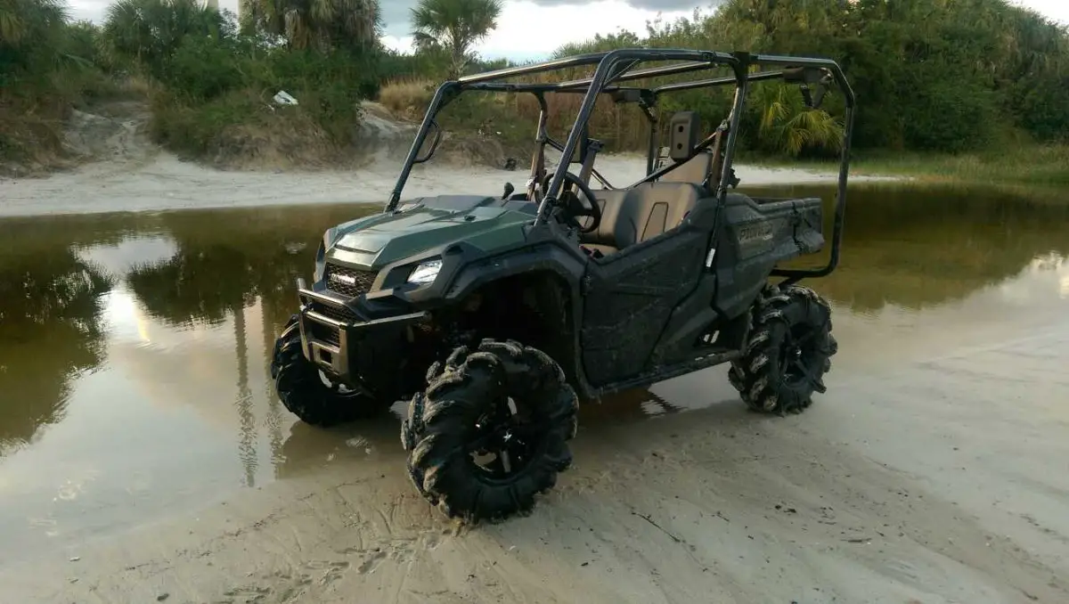

29.5 outlaw2's

stock.... this is with 4+3 offset MSA battle rims with 1" spacer/adapters.
they do rub ever so slightly. they are 4/110 rims thus the spacers. will be purchasing some 5+2 offset rims with he correct pattern in hopes of moving them in 2" per side.

It looks sweet!!
