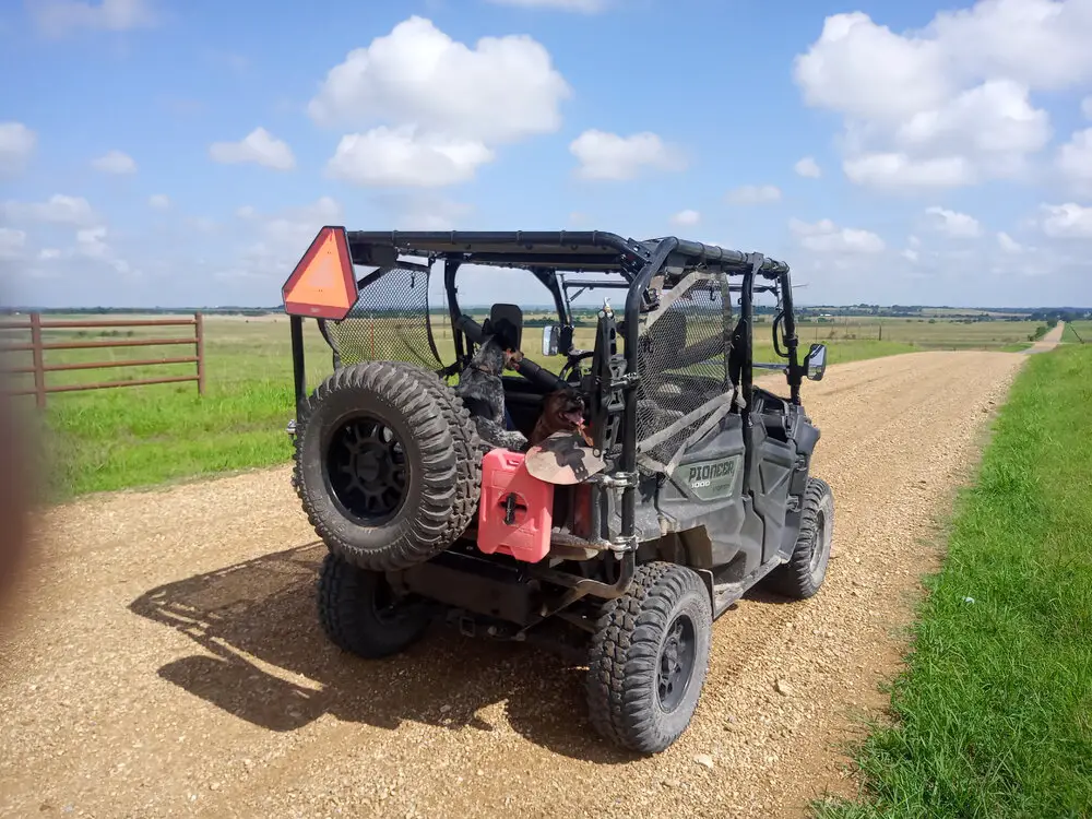

I went with Tensor Regulator 28-10x14 specifically for the super thick sidewall and toughness. One member here reported the sidewalls are about 1/2" thick! They are a DOT LT mud type tire...
Mounted on Method 409 "Bead Grip" non-bead lock wheels. With the Method bead system and these stiff side walls I'm guessing I can still drive on a flat tire without bead separation. One other member mentioned it took 4 guys with a machine to get the Tensor bead over the rim and mounted.
Dirt Road Fabrication spare tire/fuel system with 5 matching wheels and 1" RB3 Offroad rear spacers. Love this set up!
Dirt Road Fabrication spare tire/fuel system with 5 matching wheels and 1" RB3 Offroad rear spacers. Love this set up!View attachment 214794

T-Bear:
Good looking set up. I have some questions.
Is your suspension stock? Yes, all stock suspension. My unit was a "basic" unit.
Any clearance / rub problems with that set up? Absolutely none. Plenty of clearance left. These tires measure 27 3/4" tall at 13psi.
How do they perform in the mud? Don't know yet. But I'd imagine "average" since it is a somewhat tight mud tread pattern.
How much stiffer is the ride compared to the stock tires? A little stiffer, but I don't notice it all anymore. I think the initial impression has to do with the fact that my "basic" OEM tires were only 4 ply and had a very soft side wall.
How much air pressure are you running in the tires? I'm running 13psi. Tensor recommends only 15psi max for "flats". My buddy in AZ runs his a little less than me at 10psi. However, I run more long distance gravel/dirt roads and a fair amount of pavement.
Did you buy the wheels and tires as a set or separately? Where did you get them from? I initially bought my spare wheel/tire while I was still running down my OEM tires. I then bought the new set at once from Rocky Mountain ATV. The spare and new set were all delivered mounted. I would have bought from KJ Motorsports as they were about $200 less, but out of stock.
Did you buy the spare tire rack direct from the manufacturer? I bought my rack from Jared at Dirt Road Fabrications. I did a bunch of research from threads here, and his unit was the more stout in materials and design in my opinion. Jared was AWESOME to deal with. My buddy in AZ bought the same unit and is also happy. I have over 1200 miles on his unit and NO problems or loose clamps.
Here is the thread on the Dirt Road Fab unit vs. others that convinced me.
Here is the Dirt Road Fabrication Tire/Fuel Carrier I went with...
Thanks for your help! You're very welcome! Enjoy your new toy!
