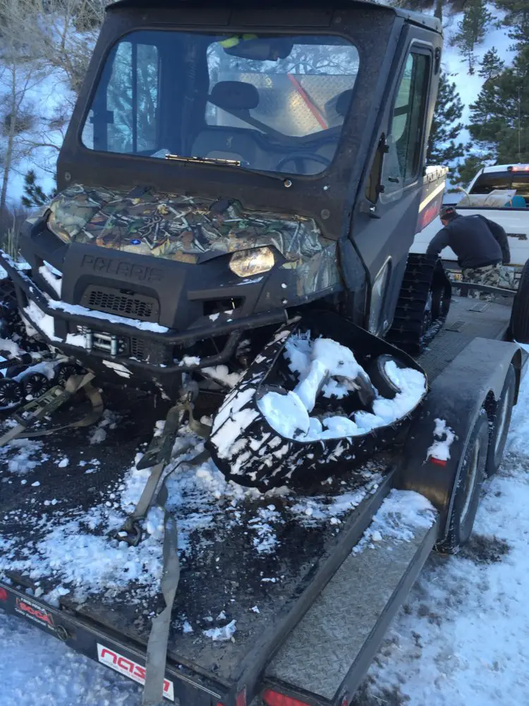

I've used tracks quite a bit on quads and Rangers. Dont have any for the Pioneer yet. A couple of things to watch for. It is very easy to bend tie rods in the front when using tracks. If you bump a rock buried in the snow, the steering rods can bend pretty easily. We bent two last winter on a ranger.
About the only way to get a tracked machine stuck is to go over a large enough log. It will go over it with the fronts easily but the back tracks won't. You end up with the log in between the front and rear tracks and can't go forward or back. Smaller logs are no problem. We carry chainsaws all the time now.
There are heavy duty tie rods available for the Rangers. Hopefully someone will come out for a set for the Pioneer.
Ouch ! that looks like more than a broken tie rod.
39,129
Would it make more sense to carry spare tie rods instead of upgrading to bigger ones? I think I would still want to have the factory tie rod is the weak link and not risk breaking a steering rack.
42,062
322,675
Seems reasonable. Weak links are very good sometimes easy to fix.
