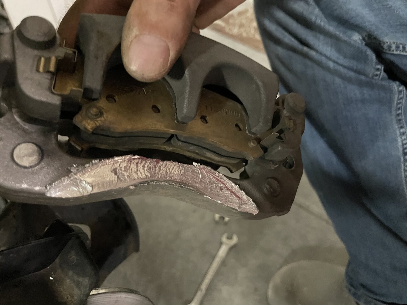

Thank you all for the responses. I took the wheel off to get a good look and sure enough, loose rotor bolts. 4 of 5 were loose, one of which was causing damage. Images attached. All snugged up and back in action.

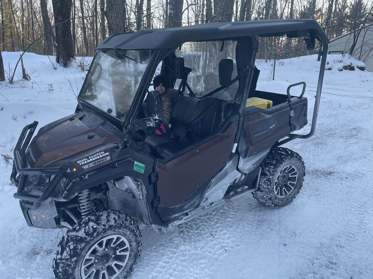

Sorry about violating rule #4. Pic was from when I picked it up this past winter and was ice fishing with it. Love it, so far …
The caliper took some punishment but its in good working order.
