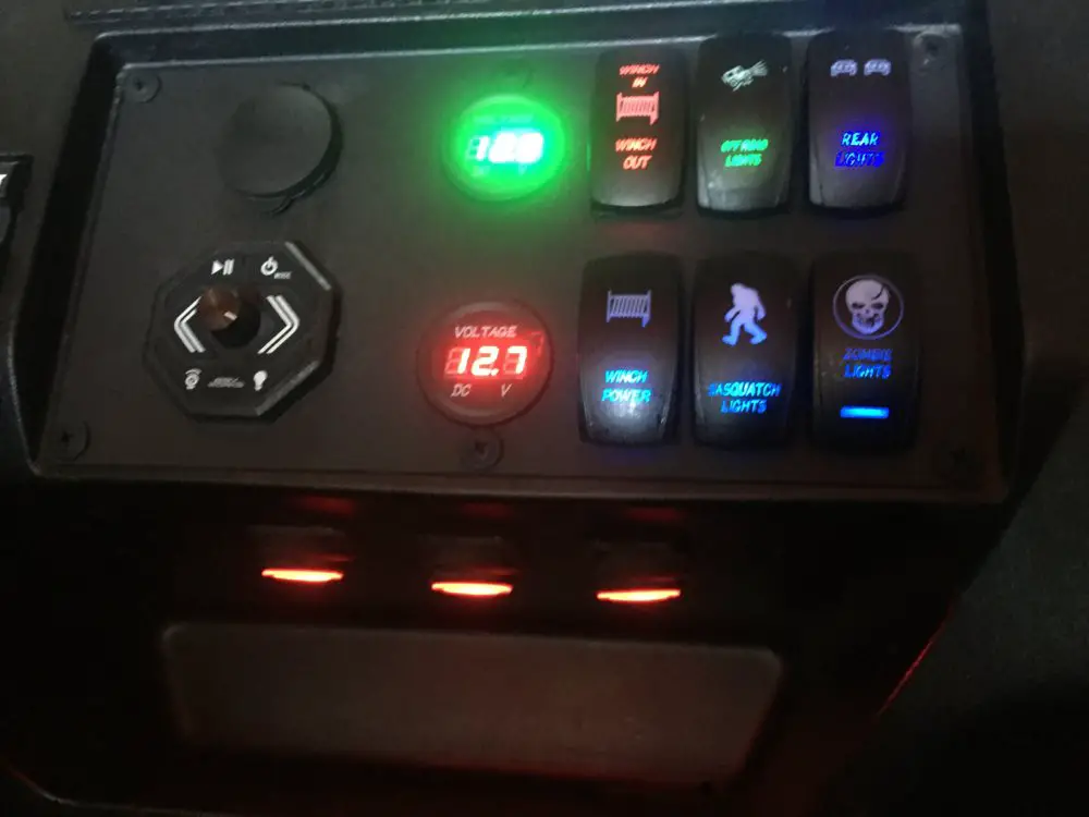

Agreed! I constantly monitor batteries condition and draws on electrical system using separate battery meters as seen in photo. If the draw is to great I adjust usage accordingly.
Same here. Although, while running, I've never seen my voltage below 13.6.
