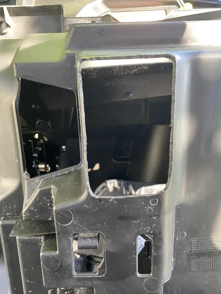

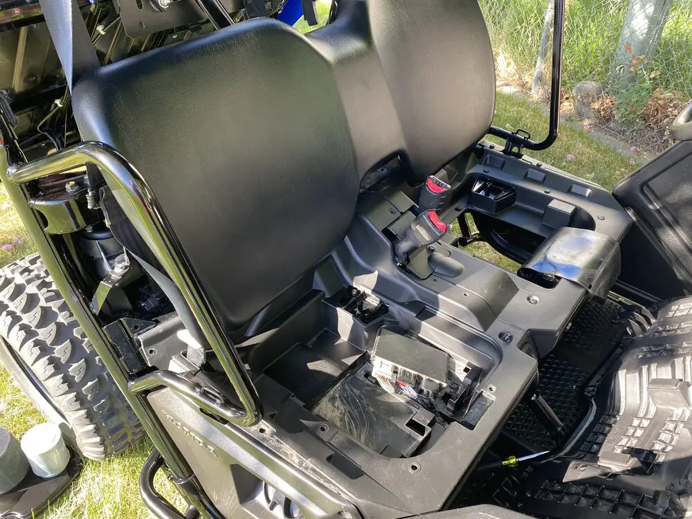

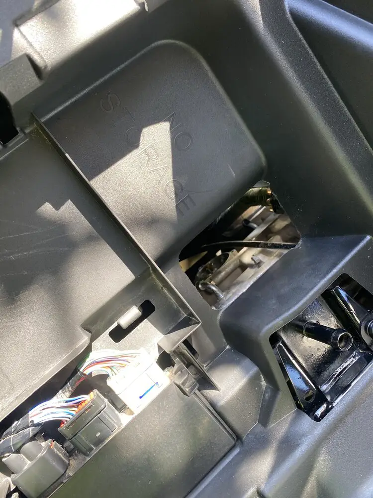

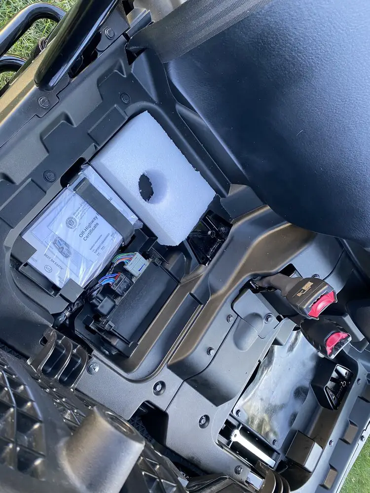

Today was my first attempt at servicing my new P520. I hit the 100 mile mark when i was out last weekend so I made it a point to wash it up and prime it for service. Everything was pretty straight forward between the videos and owners manual until it came to the oil filter. What a pain. Really, have to remove all those little plastic clamps and what not? So i decided to cut into the bottom panel; similar to the opening that is under the driver seat to access the dip stick.
Took my trusty router; routed out a whole wide enough to get my hand in there (can actually get both ands in there with some special articulation); created a cover with some spare styrofoam and called it a day. So next time, I should have to remove all those little clips and what not. Plus i can now clean better on that end. And if you are wandering what the hole is in my styrofoam cover, its to accommodate the seat support.

Great job, I like it!

Yeah it’s on here somewhere. But definitely a solid upgrade to the oil change experience.

That is f***ing brilliant!

One of the best ideas for sure over the years. Alongside the @trigger shield. Thanks guys.
Yep. People keep giving me credit for it, but I actually saw someone else do it...on here I think. They must have moved on.

There was another thread on the idea. Your router cut is cleaner than the original thread.
I have the removal tool for the little connectors so it’s only a pia so often.

I agree. That other one just looked terrible.

need all the room honda gives without the floor, so wacked it back over the tank with a jig saw and wide out to the upright plastic piece molded in. cant see it under the rubber flap i put over it and the seat over that. oil change is just like the floor is not there. great mod!!!
