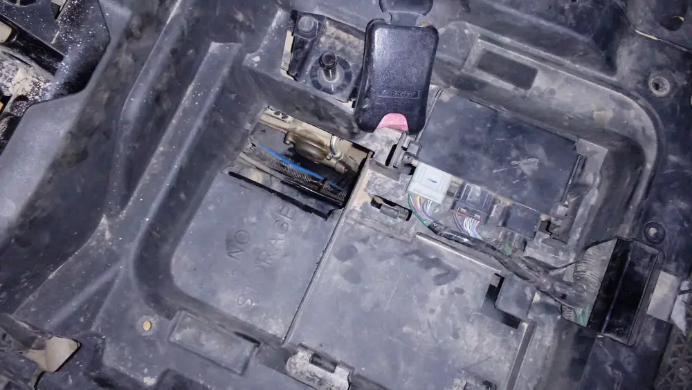

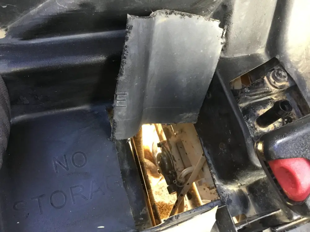

After pulling screws and pushpins repeatedly every time the oil needed to be changed, I decided I'd had enough and did what Honda failed to, and cut an access hole under the seat:
20190404 200924 jpg
Might go back and add a flap later, but for now, all I gotta do is just reach down and remove the filter.
If you try this, I suggest you remove the panel, as the gas tank is very close to the bottom.

Changed my oil this evening, and did this mod first. Put the plastic back on and changed the filter through the new hole, no problems at all. Thanks for a GREAT IDEA!!!

I imagine engine noise to cab, engine heat to cab, might be a little increased with this mod...but it's obviously worth it or folks wouldn't be doing it. Yes, seems like Honda could easily add an access port/door right there. Good thinking.

Also, what are the dimensions of that cut-out? Wondering if a 4-5" holesaw would clear brackets/bracing. Maybe use a toilet flange and a fernco cap to make a little hand-hole....

This was 4 x 4.5. Allowed removal of filter housing and arm to tighten bolts. Maybe 4 in would work.

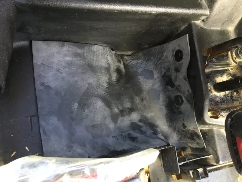

No problem with Trigger shield, extra flap for water splashes to protect ECM. Always keep some extra push pins around.
