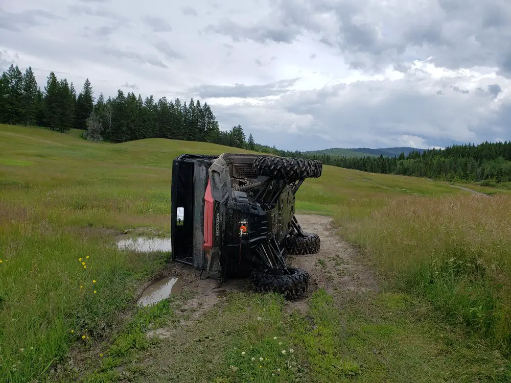

The p500 tips over easier than an atv! Two different ATVs went before me when I rolled mine. I was exactly in their tire tracks
