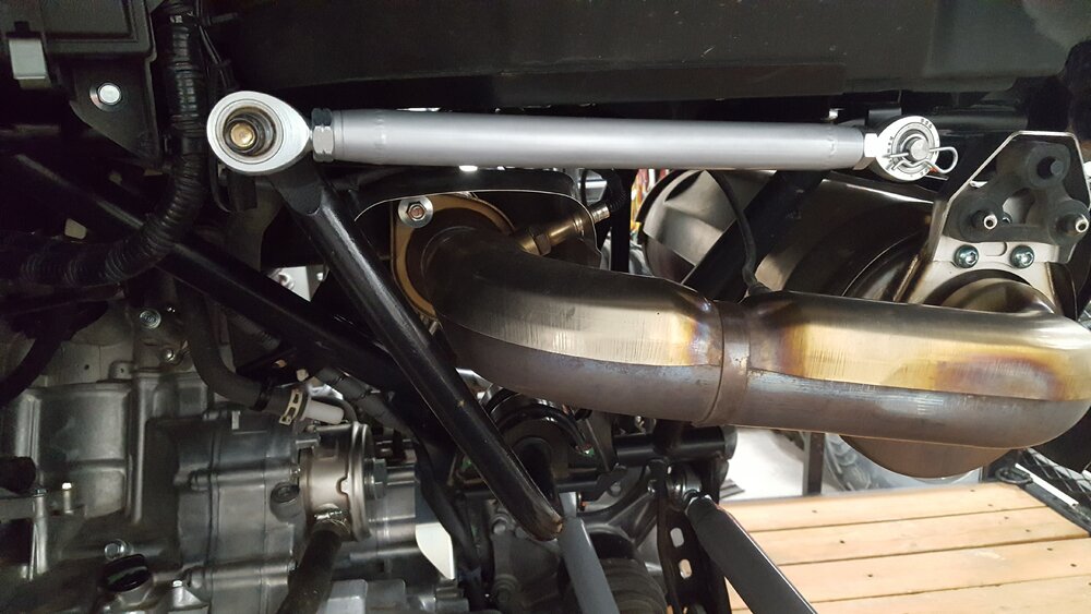

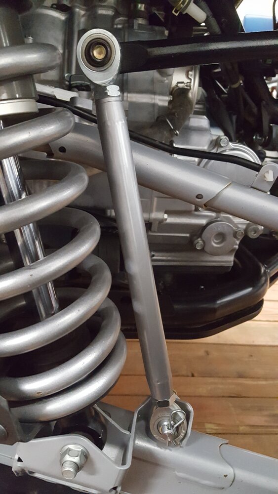

So as you can see, it depends on the ground you are traveling on and the type of driving, and not so much the angle. This is why I chose to install a Quick Release Sway Bar Link Kit on my Talon. If the terrain/driving style changes, I can stop, connect or disconnect the sway bar in about 30 seconds and off I go. By far the best $200 spent on my machine so far...
Attached...

Detached and stowed away...
Attached...
