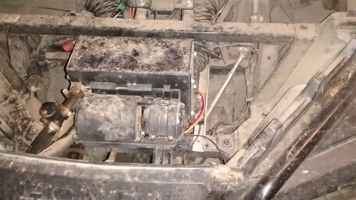

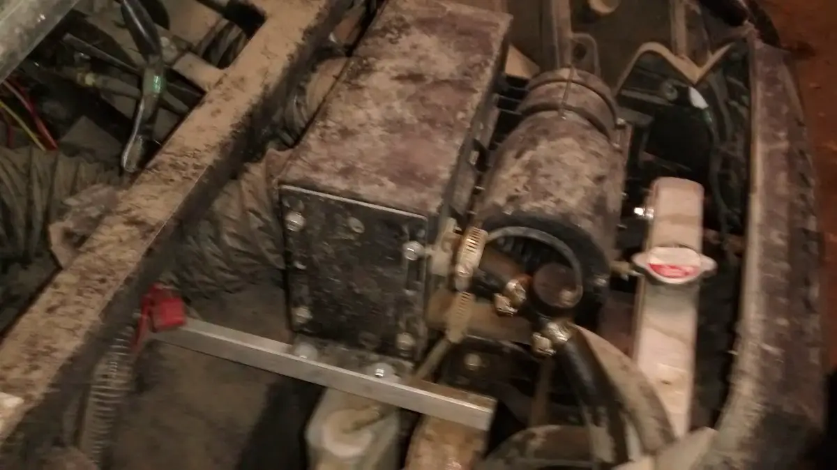

I actually installed this exact heater on my p500 before last winter. I installed in under the hood, and haven't been overly impressed with the heat output. Have to really be running hard to get any heat and even then it's not much. I'm probably going to remove my y's and direct all coolant from engine to heater then to radiator. I just don't think the little 500 makes enough heat.

That 4 way valve is very expensive and I promise you it will not put out much heat unless most of the coolant is going to the heater. I have the full cab enclosure and you have to shut the heater off and let it warm up or it will blow cold air. I'm going to try and run it inline, I don't see what it could hurt. My 500 never runs warm and I had the radiator completely blocked off last winter and it still ran cool.
IMG 20151031 190644529
IMG 20151031 190701433
Sorry pics are dirty. I use my 500 everyday for work so it gets a lot of use and isn't pampered.

I'm glad you pointed it and yes, I'm very curious about inline position and heat output test. As I pointed earlier, I did not see any extra internal circle to cool engine (except small 5 or less mm tube that connects intake with thermostat) like in P700 or P1000, so indeed P500 does not put a lot of heat.
And awesome pics, I was wondering how bad dust gets inside and was planning to hide summit heater inside of underhood storage box and cut out opening and put regular round air filter to clean air before it goes via heater and then inside cab.
