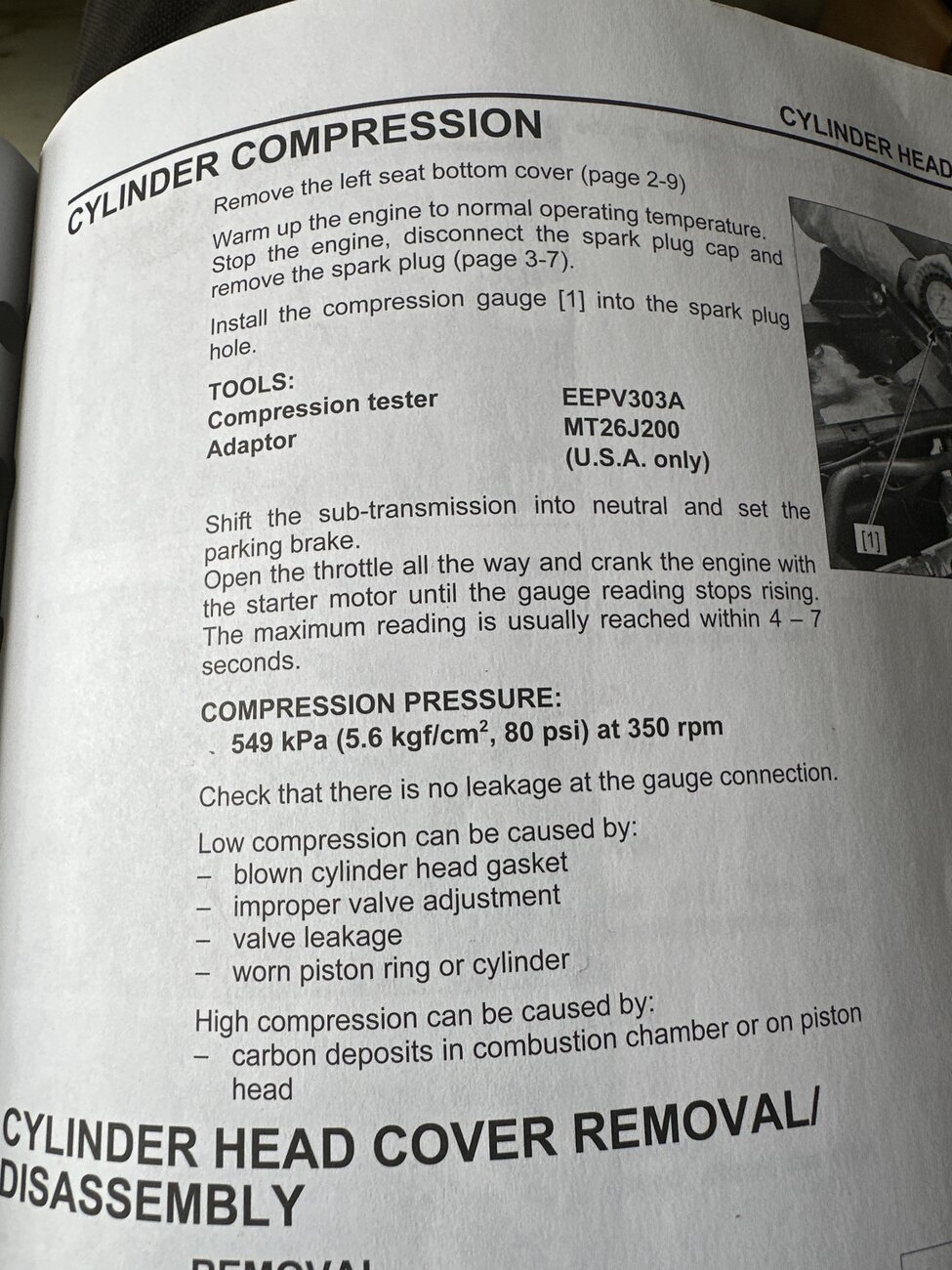

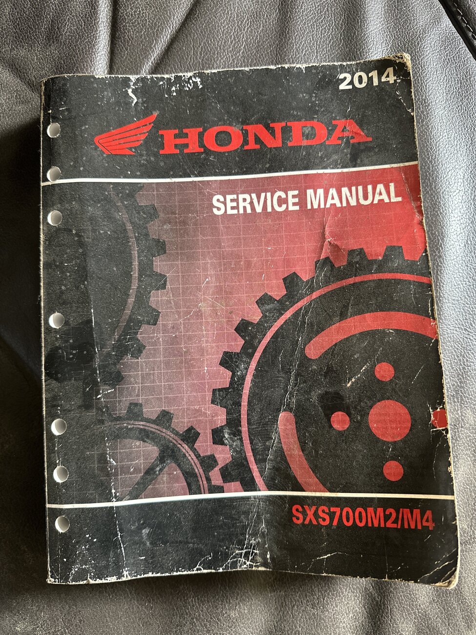

Have already done new plug (old one was fouled) so tried new air filter and checked to see if air was pulling and yes it was. Tried new fuel still same problem and had new battery not long ago. Also the manual I bought said 80PSI is normal maybe I have the wrong book?
View attachment 418940 View attachment 418941
same manual and same compression spec here.
I was wrong - forgot about compression release -outta talent now - that motor kinda sounds outta time/bent pushrod/sticky valve
