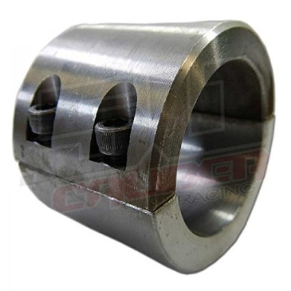

Where did you get or how did you make the clamps that clamp on the roll bar?
